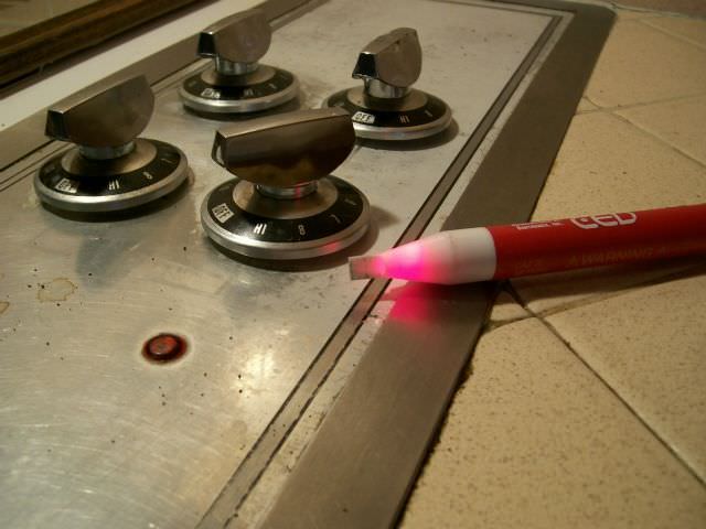

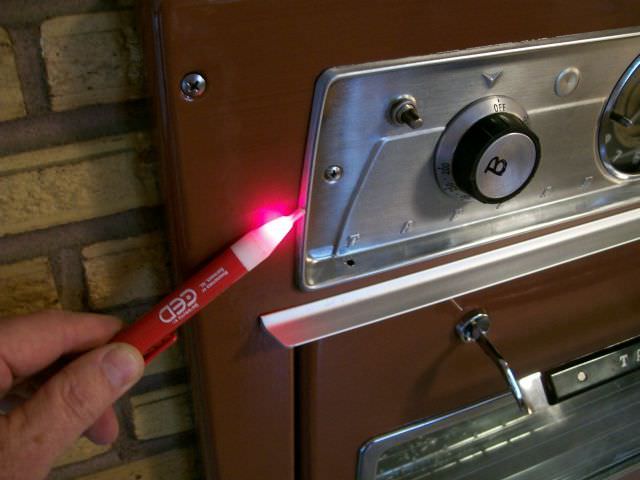

Mr. Electric Posted June 4, 2009 Report Share Posted June 4, 2009 I ran into these on an inspection recently. I did not measure the voltage, but there certainly could be a possible shock hazard. BE CAREFUL OUT THERE! Click to Enlarge 45.51 KB Click to Enlarge 42.99 KB Quote Link to comment Share on other sites More sharing options...
Michael Carson Posted June 4, 2009 Report Share Posted June 4, 2009 Were you able to find the reason for this? Quote Link to comment Share on other sites More sharing options...
Jerry Simon Posted June 4, 2009 Report Share Posted June 4, 2009 No appliance ground, I would imagine. Quote Link to comment Share on other sites More sharing options...
Kyle Kubs Posted June 4, 2009 Report Share Posted June 4, 2009 I've seen several instances where metals have become just slightly magnetized from being repeatedly heated. Any chance thats what was going on here? I would have put a voltmeter on it just to double check. Quote Link to comment Share on other sites More sharing options...
Billy_Bob Posted June 4, 2009 Report Share Posted June 4, 2009 I've seen older ranges where the insulation on the wiring inside has shrunk back exposing live wires. These can be rewired with new special high temperature rated range wire. This stuff is not cheap... http://www.infraredheaters.com/wires.htm Quote Link to comment Share on other sites More sharing options...
Mr. Electric Posted June 4, 2009 Author Report Share Posted June 4, 2009 The oven and cooktop both lit up when any knob was turned on. I would agree that more than likely they are not grounded. There is the possibility that there is a short in the appliance, and since they are not grounded the case could be energized. I just want to let all of you know that you need to be careful when touching anything electric. Don't make your body the path (don't touch anything if you are grounded) for electricity. Quote Link to comment Share on other sites More sharing options...
