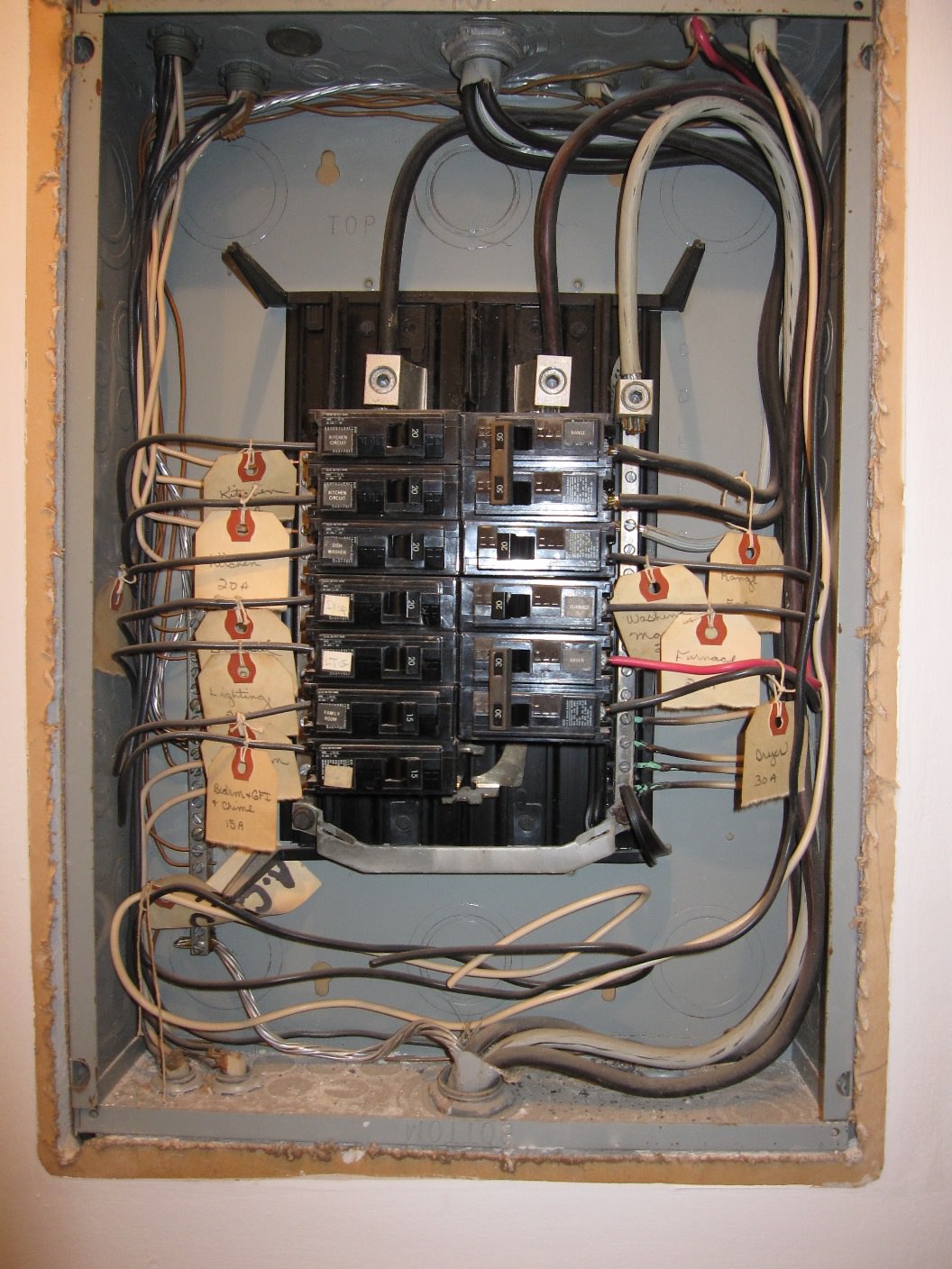

dtontarski Posted June 6, 2009 Report Share Posted June 6, 2009 I've never seen grounded conductors in this condition before. What may have caused this? Download Attachment: Copy of Dan 014.jpg 507.91 KB Download Attachment: Copy of Dan 018.jpg 453.37 KB Quote Link to comment Share on other sites More sharing options...
Robert Jones Posted June 6, 2009 Report Share Posted June 6, 2009 From the look of the sheathing, it looks like it could be over heating. But then again I remember reading on this board about corrosion from stored chemicals. Was this located in a laundry room or what may have been a laundry room at one time? Any chemicals stored in the immediate area? Quote Link to comment Share on other sites More sharing options...
dtontarski Posted June 6, 2009 Author Report Share Posted June 6, 2009 Rob - It is in a condo's mechanical room with a ng water heater and furnace, and the laundry room is right next door. We're thinking along the same lines. I think I've seen a post here about chemicals corrosion too. Dave Quote Link to comment Share on other sites More sharing options...
hausdok Posted June 6, 2009 Report Share Posted June 6, 2009 Those have clearly been overheated. The plastic insulator behind the breakers is all melted from the heat. I'd guess that there are (or were) some really loose terminals there. ONE TEAM - ONE FIGHT!!! Mike Quote Link to comment Share on other sites More sharing options...
dtontarski Posted June 6, 2009 Author Report Share Posted June 6, 2009 How about loss of conductivity due to the corrosion resulting in over heating and the scorching of the insulation? Quote Link to comment Share on other sites More sharing options...
Jim Katen Posted June 6, 2009 Report Share Posted June 6, 2009 I've never seen grounded conductors in this condition before. What may have caused this? It was caused by loose connections. If it were corrosion caused by something in the environment, the other conductors in the panel would be likewise affected, particularly the bare grounding wires. The electrician sticks all of the neutrals in the terminal bar, is about to tighten them down, and then gets distracted by something. Next thing you know, he's forgotten about them. Oftentimes, the circuits will work just fine for years before someone notices there's a problem. - Jim Katen, Oregon Quote Link to comment Share on other sites More sharing options...

Scottpat Posted June 7, 2009 Report Share Posted June 7, 2009 I've never seen grounded conductors in this condition before. What may have caused this? Download Attachment: Copy of Dan 014.jpg 507.91 KB Download Attachment: Copy of Dan 018.jpg 453.37 KB Is that not a panel (not service panel)? Also the burnt conductors are neutrals, not grounds. Just pointing this out so that it won't end up in your report the wrong way. Quote Link to comment Share on other sites More sharing options...
