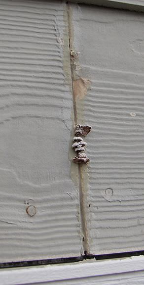

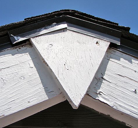

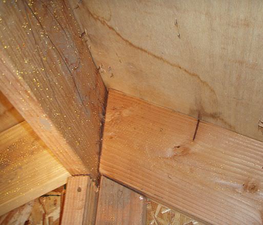

Ken Meyer Posted June 15, 2009 Report Share Posted June 15, 2009 Has anyone seen mushrooms growing out of Hardie plank? This was a first for me. This is on the gable end of a garage, south side. Most of the butt joints have been recaulked, the house is 8 years old. From the garage attic, I do see some water stains on the roof sheathing at the peak. The mushrooms are growing out from lower down, about 18 to 20 inches off to the side below the peak. The OSB looks fine from the garage attic, no staining at all or other signs of moisture. I would think that if mushrooms are growing in the OSB, there would be more evidence. My moisture meter placed right next to the mushrooms picked up only a slightly (2 per cent) elevated reading compared to the rest of the siding in that area. Of course, it's nice and dry now. Can the mushrooms be growing out of the siding? I can't really tell where the water is coming in, my best guess is wind driven rain getting in under the shingles or around the flashing at the peak. I couldn't stick around too much when trying to get a closer look at the peak, there were two yellow jacket nests under construction right behind the barge rafter, but I did get a couple of pix before being driven back down the ladder. Click to Enlarge 40.12 KB Click to Enlarge 43.16 KB Click to Enlarge 53.32 KB Quote Link to comment Share on other sites More sharing options...
Richard Moore Posted June 15, 2009 Report Share Posted June 15, 2009 Looking at the color of the area just above the mushrooms as well as the way the filler appears to have been scraped, rather than squeezed, into the gaps, I wonder if they used some interior grade wood filler, rather than an exterior grade "caulk". That might be what the fungi is feeding on. Quote Link to comment Share on other sites More sharing options...

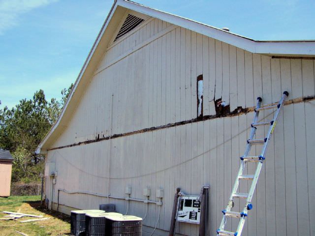

Bob White Posted June 16, 2009 Report Share Posted June 16, 2009 I'm guessing that water is running down the siding, hitting that horizontal surface just below the fungal area and wicking back into the OSB sheathing. The same kind of thing happened below, where a horizontal trim board directed water to the siding seams. Lots o' rot... Click to Enlarge 50.44 KB Quote Link to comment Share on other sites More sharing options...

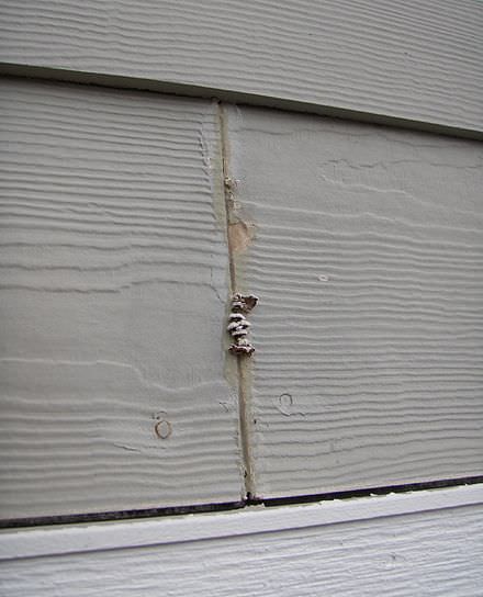

Ken Meyer Posted June 16, 2009 Author Report Share Posted June 16, 2009 I think Richard is onto it. His theory explains why the OSB still looks good. Mushrooms are just the fruiting bodies of the fungus, which has to have been there awhile before the mushrooms sprout. The OSB would show evidence if it had been wet for years. Here's a closer look. Click to Enlarge 28.53 KB Quote Link to comment Share on other sites More sharing options...
