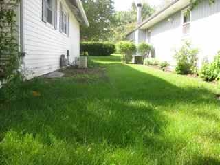

CrappyOldHouse Posted June 18, 2009 Report Share Posted June 18, 2009 Hi there, Thanks in advance to any suggestions or comments that you all can offer. I bought a house that had water problems in the basement. When the inspector checked it out, he made it sound like throwing some dirt down around the foundation to change the grade and extending some gutters would solve the problem easily. Unfortunately that wasn't the case. I have a very low house, relative to other houses in the neighborhood. The point at which the next door neighbor's house's siding and foundation meet is about a foot higher than mine. The property line is about 12 feet from their house, and only 6 feet from mine. I cannot add dirt near my foundation, because the land is already only a few inches from the base of my siding. I've considered putting some drainage near the property line, but this is pretty much the lowest spot on my land all the way to the sidewalk. WHAT I'M CONSIDERING DOING is to put 2x12 pieces of treated lumber about 6" from the siding, on their side, and adding dirt against those boards to fix the slope. -Does anyone have any experience with this? -Other things I should consider? -Reasons why I shouldn't do this (with an alternative)? Again, thanks in advance for your help!!!!! Colin Click to Enlarge 15.46 KB Click to Enlarge 14.66 KB Quote Link to comment Share on other sites More sharing options...
hausdok Posted June 18, 2009 Report Share Posted June 18, 2009 Hi, There's no need to "add" dirt if all you need to do is take some away. Why don't you and the neighbor get together and put a curtain drain right on the property line and then regrade both yards so they slope into a drainage swale located directly above the drain? ONE TEAM - ONE FIGHT!!! Mike Quote Link to comment Share on other sites More sharing options...
kurt Posted June 18, 2009 Report Share Posted June 18, 2009 My thoughts exactly. Drainage swale, curtain drain or other drain mat, and carve the earth to form the swale. Quote Link to comment Share on other sites More sharing options...
Les Posted June 18, 2009 Report Share Posted June 18, 2009 Mike and Kurt have the right idea. Drainage issues are seldom very complex so the obvious remedy is overlooked. Water runs downhill. I suspect we recommend adding dirt one time per hundred problems. We have very good results with swales and I believe them to be ecologically sound; no erosion, very little ponding, easy to construct with natural materials, etc. Quote Link to comment Share on other sites More sharing options...
Richard Moore Posted June 19, 2009 Report Share Posted June 19, 2009 Am I seeing the neighbors house in that first photo with a downspout discharging above grade towards the problem area? If so, that's not helping either. Quote Link to comment Share on other sites More sharing options...
Jerry Simon Posted June 19, 2009 Report Share Posted June 19, 2009 Elaborate a bit, if you will, on what sort of basement seepage problem you have. A visible wall crack leaking? Wet carpet in a finished basement? Grading might not be the entire answer. Quote Link to comment Share on other sites More sharing options...
hausdok Posted June 19, 2009 Report Share Posted June 19, 2009 Hi, Go here. This is the perfect little setup to put under a swale. http://www.varicore.com/PDF_Documents/I ... _guide.pdf ONE TEAM - ONE FIGHT!!! Mike Quote Link to comment Share on other sites More sharing options...
StevenT Posted June 19, 2009 Report Share Posted June 19, 2009 What does the rest of the property look like? Curtain drains and swales sound good, so long as you have the elevation for them to pitch/drain. If not, you may need to install a sump pit and pump. Even then, where will the pump drain to? Quote Link to comment Share on other sites More sharing options...
John Bubber Posted June 19, 2009 Report Share Posted June 19, 2009 You/others need to find how/where water is getting in. Need to correctly identify the problem(S). Grading/adding soil and sloping it away does NOT identify how/where water is getting into the basement nor does it fix/repair whatever your problem(S) turn out to be. Other than some sort of interior leaky plumbing fixture,most basements leak due to one or more of the following......... -The wall(s) has crack(s),loose-cracked parging,one or more open-leaky rod holes,opening where a service-line enters etc -Opening(s) above ground level such as...open mortar joints,loose siding,openings/gaps in-around-under basement windows and doors -A possible blockage/clog in the lateral line between house and street,possible problem on CITY`s end/beyond the street. Or if there is an existing sump pump and pit,a possible need to adjust sump or replace it or possible need to snake tile(s) that empty into pit or, need to drill holes/create openings in pit-wall. Raising the grade/lowering the grade,extending downspout extensions 1 mile away,mudjacking slabs etc does not IDENTIFY the above problems-possibilities NOR does raising the grade etc fix/repair those problems. Further explain, raising the grade etc does not waterproof an existing crack,loose cracked exterior parging (a defect-flaw) in a basement wall. Raising the grade etc does not tuckpoint possible open mortar joints,does not caulk aroun-replace window/doors, does not snake-rod possible blockage in a lateral line or tile that empties into pit,does not adjust-replace a faulty-old sump and so on. Here is a homeowner (one of many) who TRIED raising/sloping the grade and also dug down and poured concrete against the basement wall where water was coming through a crack,didn`t do squat,never does. http://www2.snapfish.com/thumbnailshare ... 111847456/ play slideshow or click individual pic`s Here is a block wall, they often have EXTERIOR cracks and/or loose-cracked parging on the OUTSIDE of the wall, this is where water first enters into the hollow blocks and is most often only seen inside basement at-along the FLOOR-WALL joint. Raising the grade etc does NOT repair/waterproof the existing exterior cracks....the cracks/openings are THE problem,period. http://www2.snapfish.com/thumbnailshare ... 111847456/ Underground ROOTS against basement wall CAUSED exterior cracks in wall which then allowed water,insects to enter.Inside drain tile/pressure relief systems and/or raising the grade etc does not remove the CAUSE of the cracks/leaks,does not repair/waterproof these cracks http://www2.snapfish.com/slideshow/Albu ... _111847456 Adding soil,clay especially can INCREASE the lateral pressure AGAINST a basement wall,can cause problems. Your water problems in basement should have been correctly and honestly identified BEFORE you made offer on house and imo, the inspector was incompetent/negligent on supposed-solution/recommendation Quote Link to comment Share on other sites More sharing options...
Les Posted June 19, 2009 Report Share Posted June 19, 2009 Colin, I am sure there is a qualified inspector in your area of Ill. Call him/her. email or call Kurt M and he can direct you to a qualified inspector. I really can't give expert advice based on a photo, nor can others on this forum. They are asking good questions to get more info, but sometimes we (as inspectors) get detailed before we first address the core issue. Go outside your home and look where the water goes, then proceed. Be careful of "wet basement" contractors. Get yourself an advocate (inspector) locally. Try ASHI.com, NAHI.com etc. Don't get discouraged! Quote Link to comment Share on other sites More sharing options...
