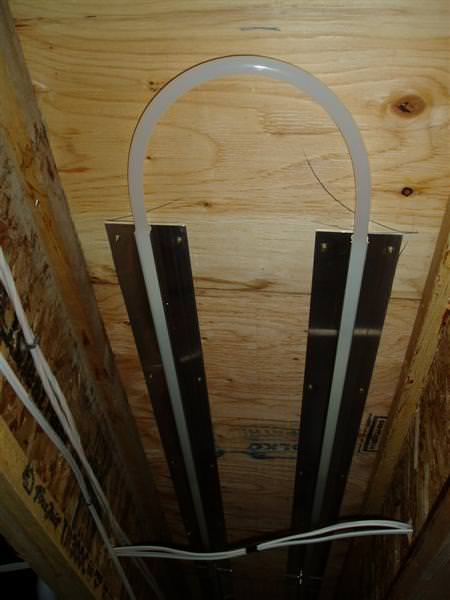

RobC Posted June 23, 2009 Report Share Posted June 23, 2009 I seldom see an expansion tank with an open domestic/radiant system. They are mostly found on closed loop systems around here. The priority valve is needed to set a priority on who gets hot water first and the length of time or weight of priority. For example, I have domestic as my first priority over radiant and fan/coil. However domestic over time looses it priority to radiant depending how I set up the 'weight' of priority. So yes, a priority valve is required to set up a system that must satisfy two different demand loads. Quote Link to comment Share on other sites More sharing options...

RobC Posted June 23, 2009 Report Share Posted June 23, 2009 LOL...well, that is just a tad more complex than what I typically see. That your own work Rob? The boiler, primary, secondary loops and zones were installed by my genius radiant guy. I installed the domestic tubing, irrigation and the JoistTrak. Incidentally, I opted for a system feeder to avoid paying the yearly backflow preventer inspection fee. There is no make up valve, double check valve or pressure reducer to the system. Quote Link to comment Share on other sites More sharing options...
