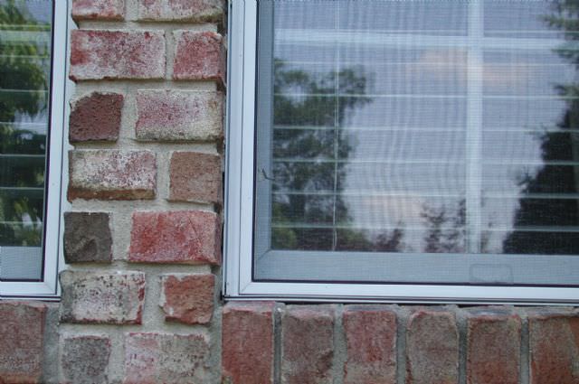

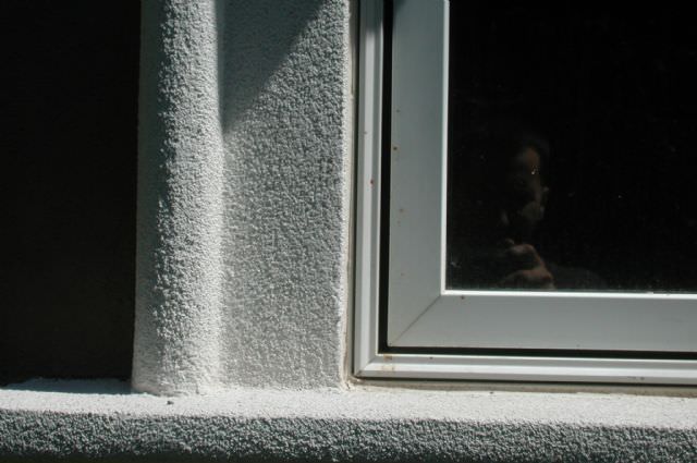

Kyle Kubs Posted July 2, 2009 Report Share Posted July 2, 2009 Ok, obviously these windows are not sealed properly but what kind of detailing would you expect to see here? Just caulking? Some kind of casing bead to terminate the brick and then Caulk? Click to Enlarge 55.77 KB Also, does EIFS type trim around the windows and door need to have a control joint between it and the hardcoat? Click to Enlarge 45.07 KB This is a $1.1 Mil McMansion with every shortcut under the sun hangin in the breeze. Some of the more obvious hardcoat stucco errors. Download Attachment: DSCN1996.JPG 959.46 KB Download Attachment: DSCN2002.JPG 878.03 KB Download Attachment: DSCN2013.JPG 1063.33 KB Download Attachment: DSCN2016.JPG 894.31 KB Quote Link to comment Share on other sites More sharing options...
kurt Posted July 2, 2009 Report Share Posted July 2, 2009 I think that's a disaster. It's a rough masonry hole with a cheap window stuffed in it. I'd want to see sills, drip caps, thru wall flashing, end dams, wicks, and some semblance of an architectural design/detail that diverted water around the opening. Could be lots of things, but it looks like there's not anything. We know by now that such methods really don't work. At all. Quote Link to comment Share on other sites More sharing options...

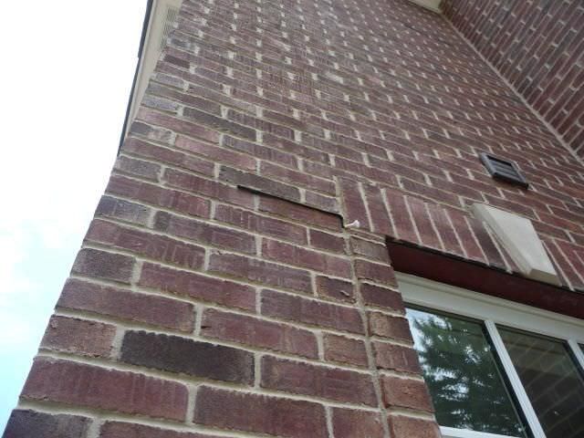

kurt Posted July 2, 2009 Report Share Posted July 2, 2009 I'm assuming there's a lintel over the opening, but....... Is there a lintel? After that, I'd want to know what the mfg. showed in their spec's. I would never have the window set out flush with the face of the brick; it should be set in, and there should be flashing above and below it. Some semblance of a sill, even rowlock brick, although I don't like rowlocks in modern masonry; they leak. Here's a couple showing some flashing details. Click to Enlarge 54.35 KB Click to Enlarge 62.4 KB Click to Enlarge 61.1 KB Quote Link to comment Share on other sites More sharing options...
Kyle Kubs Posted July 2, 2009 Author Report Share Posted July 2, 2009 Thanks Kurt. Yes there were lintels. Poorly installed like everything else, some painted, some not, most installed pretty much flush with the face of the brick so there is no hope of keeping the joint sealed and no, no flashing of any kind, no weeps anywhere... Top of Garage Doors Download Attachment: DSCN2021.JPG 947.99 KB Well the second picture doesn't show it very well but the trim around the windows is EIFS style trim with styrofoam behind it and the field of the wall is all modern hardcoat. Should there be an expansion joint/control joint between them? I really hate new houses. Quote Link to comment Share on other sites More sharing options...
