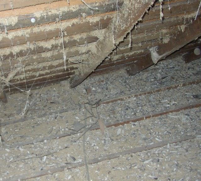

Richard Moore Posted July 9, 2009 Report Share Posted July 9, 2009 Nothing to do with disease but pigeons in an attic almost killed me my first year in business. I still think of it as the worst POS home I have done. I had already been scared by a live possum in the basement and found a huge bloated rat floating in the sump pump. So, later, as I start to lift the attic hatch I was greeted by a sudden loud noise that sounded like hundreds of scurrying rats and almost fell off the ladder. After regaining my composure, I tried the hatch again, slowly, and discovered the noise had been a startled flock of pigeons. Not good, but better than rats. As you can see by the photo, they had increased the R-value of the insulation. I now have a habit of first knocking on attic hatches in old houses. Click to Enlarge 107.98 KB Quote Link to comment Share on other sites More sharing options...

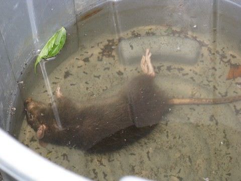

kurt Posted July 9, 2009 Report Share Posted July 9, 2009 .................and found a huge bloated rat floating in the sump pump. Pictures. We need pictures....... Quote Link to comment Share on other sites More sharing options...
Richard Moore Posted July 9, 2009 Report Share Posted July 9, 2009 Nowadays, I would definitely have taken a photo to share with the brethren but, regretfully, no photo of the the deceased. I was probably too consumed with trying to lift the float without touching the "icky" thing. For some reason (forgotten now due to age), when I first started I used to only take photos that I thought I might actually use in the report. I only have 57 photos total in that folder on a house I would likely take well over 200 shots of now. This place was only my 14th paid inspection and the first real POS. A real eye-opener...stuff they just can't train you for. The small home was occupied by an elderly lady who had lived there for 45+ years. As you entered the front door there was a narrow path through unbelievable junk leading to the kitchen, with a branch to the bedrooms. 95% of the flooring was covered with boxes, magazines and other "collected" junk. That would also have been a good photo, but I didn't take one. Quote Link to comment Share on other sites More sharing options...
Brad Manor Posted July 9, 2009 Report Share Posted July 9, 2009 .................and found a huge bloated rat floating in the sump pump. Pictures. We need pictures....... Click to Enlarge 29.8 KB ..... I can't see a dead rat and not take a picture [:-yuck] -Brad Quote Link to comment Share on other sites More sharing options...
