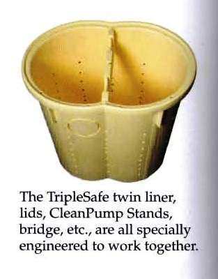

RobC Posted July 12, 2009 Report Share Posted July 12, 2009 Would anyone have a picture of a perforated sump pit? I've never seen one perforated and where are the perforations? Wouldn't that somehow short cycle the pump? Quote Link to comment Share on other sites More sharing options...
Garet Posted July 12, 2009 Report Share Posted July 12, 2009 Would anyone have a picture of a perforated sump pit? I've never seen one perforated and where are the perforations? Wouldn't that somehow short cycle the pump? Every one of them will look different, since they are typically installed by weekend warriors with a hand drill. Holes are typically on the side and bottom. Yes it's only going to pump out the volume of water in the sump and surrounding gravel; then it will sit for a period of time while water drains out of the surrounding soil into the pit. Is that what you mean by 'short cycle'? The length of time between pumping cycles would vary greatly depending on soil conditions and geometry. Quote Link to comment Share on other sites More sharing options...

Bryan Posted July 13, 2009 Report Share Posted July 13, 2009 Here are photos of two perforated pits that are used by a local basement and crawl space company. Click to Enlarge 38.17 KB Click to Enlarge 20.36 KB Bryan Quote Link to comment Share on other sites More sharing options...
