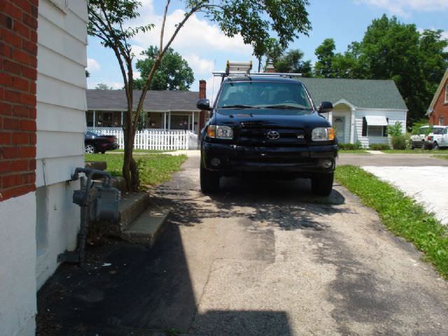

John Dirks Jr Posted July 16, 2009 Report Share Posted July 16, 2009 I wrote this up because the location of the gas and electric meters were at the end of a driveway and they had no protection from vehicle impact. In addition to that, is there a rule as to how close these two services are to each other? In other words, are they too close to each other? Click to Enlarge 53.79 KB Click to Enlarge 47.45 KB Quote Link to comment Share on other sites More sharing options...
Jerry Simon Posted July 16, 2009 Report Share Posted July 16, 2009 On the potential impact part, I would not have wrote it up. Seems like you'd have to drive a car on an angle to miss the bay window and the outside garage corner to try and hit the gas meter. Looks sort of hard to hit it even if you were trying. 'Course, the picture may be deceiving and it could look worse on-site. If so, a fair call. I recommend installing a protective concrete-filled metal post in such cases. Is that what you say? Clearance part...I never heard of anything prohibiting such. Quote Link to comment Share on other sites More sharing options...
Bill Kibbel Posted July 16, 2009 Report Share Posted July 16, 2009 On the potential impact part, I would not have wrote it up. Seems like you'd have to drive a car on an angle to miss the bay window and the outside garage corner to try and hit the gas meter. Looks sort of hard to hit it even if you were trying. 'Course, the picture may be deceiving and it could look worse on-site. If so, a fair call. I would have included a recommendation. I got to see what was left of a block of townhomes after a meter was hit. When they were built, it wasn't required because someone thought a vehicle would never be at that particular angle. I recommend installing a protective concrete-filled metal post in such cases.Or you could recommend a bollard. Clearance part...I never heard of anything prohibiting such.Check with the local gas co. Many require that the regulator be set more than 36" away from the electric meter and/or the meter and gas piping be 36" from the grounding electrode. Quote Link to comment Share on other sites More sharing options...
John Dirks Jr Posted July 17, 2009 Author Report Share Posted July 17, 2009 I didn't specify the exact means of protection. Here is a quote from the report. The gas meter is in a location that it is subject to damage. At the head of the driveway, it could be affected by vehicle impact. This can cause a major gas leak which is very dangerous. An appropriate barrier needs to be installed to protect this gas meter and its piping. Have a qualified contractor fix it. Quote Link to comment Share on other sites More sharing options...
Bain Posted July 17, 2009 Report Share Posted July 17, 2009 Like Bill said, I would recommend rather than quasi-mandate. Remember that the utility company takes a look at that meter once a month and, presumably, sees nothing wrong with the installation. The meter in the photo below was beside a 50 year old house, but apparently no one from the local utility co. minded where it was. Click to Enlarge 65.19 KB Quote Link to comment Share on other sites More sharing options...

ghentjr Posted July 18, 2009 Report Share Posted July 18, 2009 Is it just me, or did anyone else notice the electrical box at or slightly below grade? Water? Rust? Snow? Where does the plow push the snow pile? Quote Link to comment Share on other sites More sharing options...
