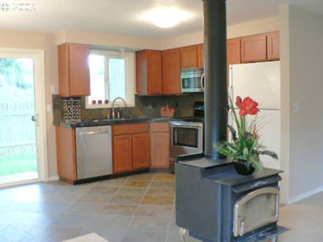

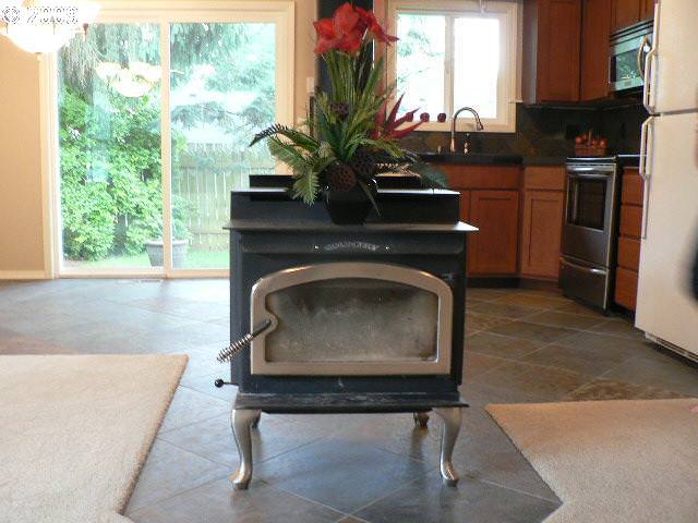

Brandon Whitmore Posted July 26, 2009 Report Share Posted July 26, 2009 This woodstove is in the house of an upcoming inspection. I can't remember the last time I saw a woodstove centered in a room like this: Download Attachment: WOODSTOVE.jpg 32.03 KB Download Attachment: stove.jpg 53.08 KB It's centrally located so it should heat the house pretty well. What are some drawbacks to this installation, if any, besides the child safety concern? Quote Link to comment Share on other sites More sharing options...
Jim Katen Posted July 26, 2009 Report Share Posted July 26, 2009 Where will they store the wood that's about to be burned? It looks as if the stove is surrounded on three sides by white carpet. There's a bright idea . . . not. The place is going to get filthy fast if they actually use the stove. If they don't use the stove, then they have this ugly dirty thing in the middle of their great room. As for the kids, when mine were little, we kept a gate around the woodstove (which was our only means of heating the house in those days). It worked fine but I cursed it daily until the little rug rat was old enough for us to remove it. How's your hind paw doing? - Jim in Oregon Quote Link to comment Share on other sites More sharing options...

Gibsonguy Posted July 27, 2009 Report Share Posted July 27, 2009 Aside from the concerns about child safety, this is the best possible configuration for heating efficiency and clearance to combustibles. Is there a data plate on it? C.T.C. on an uncertified wood stove is 48" Quote Link to comment Share on other sites More sharing options...
Jim Katen Posted July 27, 2009 Report Share Posted July 27, 2009 Aside from the concerns about child safety, this is the best possible configuration for heating efficiency and clearance to combustibles. Is there a data plate on it? C.T.C. on an uncertified wood stove is 48" Really? In the U.S. it's only 36". That's a certified stove, though. - Jim Katen, Oregon Quote Link to comment Share on other sites More sharing options...
Brandon Whitmore Posted July 28, 2009 Author Report Share Posted July 28, 2009 Is there a data plate on it? C.T.C. on an uncertified wood stove is 48" I'm expecting a data plate on it-- will see in the morning. Quote Link to comment Share on other sites More sharing options...
