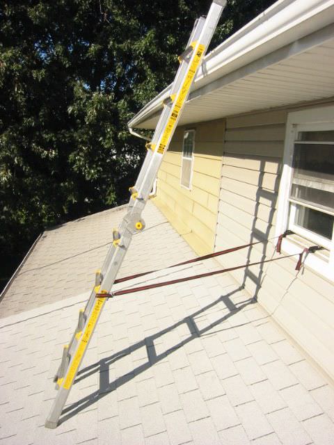

Kyle Kubs Posted August 5, 2009 Report Share Posted August 5, 2009 A few years ago, I would have balanced a Telesteps on the front-porch roof and shimmied up. I realize it sounds crazy, but I've done it a gazillion times without incident. My knees, however, aren't what they once were . . . "I've done it a gazillion times without incident." So did I, right up until the day the ladder slipped as I got back on it [:-bigeyes and I took the fast way down. I don't do that anymore. I'd do what Mike suggest. Not having a second person, and not wanting to rely on anyone's strength or attention span, I'd put a 2x4 accross the inside of the door, as high up as possible and tie the ladder to it nice and tight. I use ratcheting tie down straps. Quote Link to comment Share on other sites More sharing options...

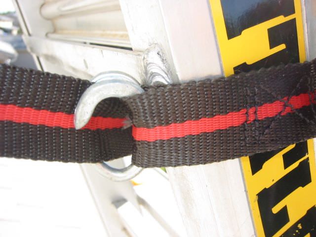

Inspectorjoe Posted August 5, 2009 Report Share Posted August 5, 2009 I'd do what Mike suggest. Not having a second person, and not wanting to rely on anyone's strength or attention span, I'd put a 2x4 accross the inside of the door, as high up as possible and tie the ladder to it nice and tight. I use ratcheting tie down straps. I have a similar rig. The straps are permanently attached to eye bolts which go through a 2X3. I couldn't imagine not having it. It's used several times a month when I can't straddle a ridge. Click to Enlarge 65.44 KB Click to Enlarge 47.06 KB Click to Enlarge 34.28 KB Quote Link to comment Share on other sites More sharing options...
Kyle Kubs Posted August 6, 2009 Report Share Posted August 6, 2009 Thats it exactly - only addition I make to mine is one of those hard rubber bungies, about 21" long, around the ladder and clipped to the gutter on both sides. Holds the ladder to the roof so well you can lean on it as you come down, so long as the gutter is attached well... Quote Link to comment Share on other sites More sharing options...
Brandon Whitmore Posted August 6, 2009 Author Report Share Posted August 6, 2009 Kyle, I thought that I was the only guy out there good enough to get a foot hooked in a wheel[:-slaphap It's always a good feeling after a nasty wreck when you are able to get up, check all of your body parts, and realize all that you have are bumps and bruises. Joe, I think you posted that set up before. Thanks for re- posting it, this time I may just copy the idea. Quote Link to comment Share on other sites More sharing options...
kurt Posted August 6, 2009 Report Share Posted August 6, 2009 That's a smart rig. If the ladder is secure, and I mean secure, doing the front porch balancing act is just fine IMHO. Quote Link to comment Share on other sites More sharing options...
