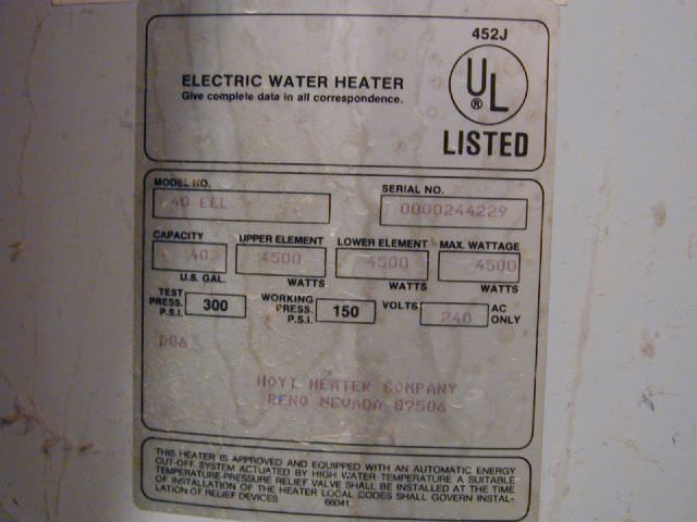

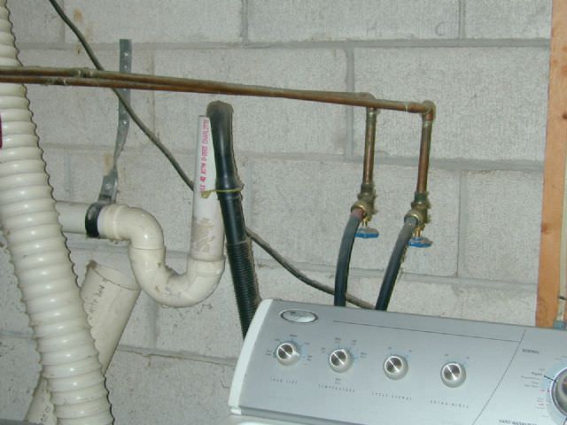

Kyle Kubs Posted August 12, 2009 Report Share Posted August 12, 2009 Ok, I've exhaust all of my secret decoder charts. Can't find Hoyt in any of them. Anyone know there stuff? Before you say it, I don't think it is 2000, it just looks a lot older then that, but I'm listening. Click to Enlarge 43.55 KB And as a reward, I'm going to let you in on the 10,001 use for that magic epoxy tootsie roll they sell on TV. Click to Enlarge 50.34 KB Secure your water pipes to the masonry wall without drilling anything.[:-censore Quote Link to comment Share on other sites More sharing options...
Robert Jones Posted August 12, 2009 Report Share Posted August 12, 2009 I thought they were taken over by American. If that is the case, then 2000 would be right. First 2 digits=year, second 2 digits=week. Here is their contact info in case I'm right;) American Water Heater Group 500 Princeton Road Johnson City, Tennessee 37601 615-283-8000 Quote Link to comment Share on other sites More sharing options...
Bill Kibbel Posted August 12, 2009 Report Share Posted August 12, 2009 In my notes, I have Hoyt out-o-bidness by the early to mid '90s. Their serial numbers started with a letter, followed by a 2-digit date. Ex: H87075483 would be 1987. I think American eventually bought their factory. What date was stamped on the relief valve tag? Quote Link to comment Share on other sites More sharing options...
Bill Kibbel Posted August 12, 2009 Report Share Posted August 12, 2009 I thought they were taken over by American. If that is the case, then 2000 would be right. First 2 digits=year, second 2 digits=week. What week is 00? Quote Link to comment Share on other sites More sharing options...
Kyle Kubs Posted August 12, 2009 Author Report Share Posted August 12, 2009 What date was stamped on the relief valve tag? They had the washing machine & dryer jammed right up against it, and it was a lowboy, I couldn't get an angle to see it. Walking the dog got a little O2 to my brain and I thought, its probably original, the house was built in 1987 - look at the tag on the lower left, there is a little D86. - It's good enough for me. Thanks for trying. Quote Link to comment Share on other sites More sharing options...
Kyle Kubs Posted August 12, 2009 Author Report Share Posted August 12, 2009 I thought they were taken over by American. If that is the case, then 2000 would be right. First 2 digits=year, second 2 digits=week. What week is 00? First week of doomsday?[:-bigeyes Quote Link to comment Share on other sites More sharing options...
