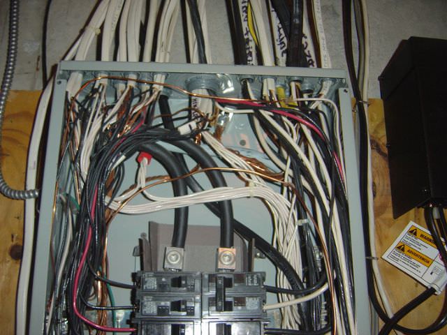

blazenut Posted August 13, 2009 Report Share Posted August 13, 2009 I inspected a 5500 sq/ft monster of a home today (8 years old) with 2 200amp panels, and no master shutoff on either panel. Should i report that one should be installed by an electrician? It was a service lateral, with two 200 amp lines entering from the meter, through the foundation wall, and directly into each panel, both panels were full. Both panels were the same as the one in this picture, Advise? Click to Enlarge 70.74 KB Quote Link to comment Share on other sites More sharing options...
Richard Moore Posted August 13, 2009 Report Share Posted August 13, 2009 Certainly, if there is no other service disconnect, then it needs fixin'. But, from what I can see from the photo, it looks like they have separated the grounds and neutrals. That would lead me to suspect there was a service disconnect somewhere before the two panels. Do you have a photo of the meter area outside and, maybe, a wider shot of the panels? Quote Link to comment Share on other sites More sharing options...
Bill Kibbel Posted August 13, 2009 Report Share Posted August 13, 2009 I'll bet anything that the main breakers were in a box at the meter. Quote Link to comment Share on other sites More sharing options...

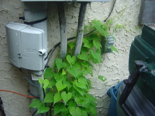

blazenut Posted August 13, 2009 Author Report Share Posted August 13, 2009 Here is the bottom of the meter... It wouldn't be inside the meter box would it? Is it common the have the main shutoff outside of the the home? And, what would the point of that be? Click to Enlarge 54.9 KB Quote Link to comment Share on other sites More sharing options...
blazenut Posted August 13, 2009 Author Report Share Posted August 13, 2009 It wouldn't have been in the transformer box outside in the yard would it? Quote Link to comment Share on other sites More sharing options...
Jerry Simon Posted August 13, 2009 Report Share Posted August 13, 2009 It wouldn't be inside the meter box would it? Looks like it might be. In your picture, I can just see the lower latch for the meterbox door. And what would the point of that be? So the fire department could kill all power before entering the house with hoses & axes a-blazin'. Such is required in at least a few local jurisdictions (about Chicagoland, anyway). Quote Link to comment Share on other sites More sharing options...
blazenut Posted August 13, 2009 Author Report Share Posted August 13, 2009 i didnt open it, i havent run into this yet, do you typically open the meters, i did notice that this specific one did not have a tag that must be cut to open it, so i guess i could have... I never knew that the main shut off could be in the meter box. Quote Link to comment Share on other sites More sharing options...

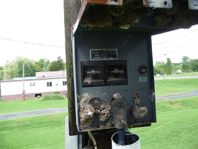

hausdok Posted August 13, 2009 Report Share Posted August 13, 2009 I don't see a service grounding conductor anywhere below that meter. If it's configured as a sub, the main disconnect and service grounding conductor and electrode should all be at the same place, no? Where does the lateral originate? Is it possible that it's a rural property with a single main disconnect on the side of a pole far from the meter and the sub-panels? The plastic case in the second photo looks like a telephone interface. ONE TEAM - ONE FIGHT!!! Mike Quote Link to comment Share on other sites More sharing options...

Jim Port Posted August 15, 2009 Report Share Posted August 15, 2009 It looks like the neutral is insulated making me believe that there is a disconnect somewhere ahead of these panels. There is an issue with the number of cables improperly secured in some of those cable clamps. I have never seen a clamp rated for more than 2 cables. Quote Link to comment Share on other sites More sharing options...
