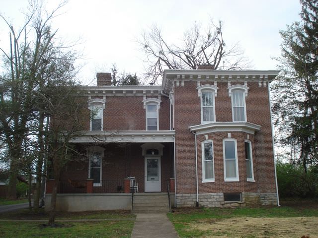

Brandon Whitmore Posted August 20, 2009 Report Share Posted August 20, 2009 My interest in old houses was piqued about 15 years ago when I flagged the approx. 3' drop off the side of the front porch as a safety hazard, same drop off down/onto to the driveway that led back to the old carriage house. The homeowner graciously explained why there was such a tall drop off. (House circa 1890) So occupants could step out of the carriage without stepping down? Quote Link to comment Share on other sites More sharing options...
Bain Posted August 20, 2009 Report Share Posted August 20, 2009 Bill, Your articles are very informative and interesting to me. The learning continues. I'll pass the links on to the client as well. With the help I get here and my own sense of reason, I think I'll have them pointed in the right direction. Keep learning and adding fuel to an appreciation of historic buildings and we'll see your name here soon: http://inspecthistoric.org/ My interest in old houses was piqued about 15 years ago when I flagged the approx. 3' drop off the side of the front porch as a safety hazard, same drop off down/onto to the driveway that led back to the old carriage house. The homeowner graciously explained why there was such a tall drop off. (House circa 1890) I know Bill K. knows why. We have that here, too. I always enjoy splaining it to folks. That, and why there's a dingy old commode stuck in a dank corner of the basement. Quote Link to comment Share on other sites More sharing options...
Erby Posted August 20, 2009 Report Share Posted August 20, 2009 Ya mean like this one! Click to Enlarge 46.12 KB In this house! Click to Enlarge 73.74 KB Quote Link to comment Share on other sites More sharing options...
Bain Posted August 20, 2009 Report Share Posted August 20, 2009 Ya mean like this one! Click to Enlarge 46.12 KB In this house! Click to Enlarge 73.74 KB Do you know why it's there? Quote Link to comment Share on other sites More sharing options...
Tom Raymond Posted August 20, 2009 Report Share Posted August 20, 2009 No, but I would guess it's for the staff rather than the occupants. Tom Quote Link to comment Share on other sites More sharing options...
Bain Posted August 20, 2009 Report Share Posted August 20, 2009 No, but I would guess it's for the staff rather than the occupants. Tom Yup, here in the scandalous South, African-American staff wasn't (weren't?) allowed to use the same facilities as white owners and guests. Quote Link to comment Share on other sites More sharing options...
