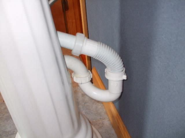

msteger Posted August 18, 2009 Report Share Posted August 18, 2009 Ran into this plumbing trap under a pedestal sink today. Due to the small opening in the rear of the pedestal, whomever installed this one had little room to work since the drain line comes up through the floor and not out into the wall. Not sure what to say about it other than it looks wrong. I would guess that the corregated section will probably be more likely to allow for clogs. Never saw one like this one. What are your thoughts? Click to Enlarge 25.86 KB Quote Link to comment Share on other sites More sharing options...
kurt Posted August 18, 2009 Report Share Posted August 18, 2009 P3002.3.1 sez drainage fittings should be smooth walled and the same diameter as the piping served. It also sez no ledges, shoulders, or reductions that would retard or obstruct drainage flow. All those ridges are the definition of ledges and shoulders that retard drainage. Commit that one to memory, as it allows us to condemn those dipsquat flex fittings. Yes, they clog. It's legal to mfg. and sell them, it's just not legal to install them. Looks like an S trap (goes into the floor). Table 3105.1 shows 1 1/4" pipe (standard lav) needs to be within 5' of the vent. If the trap is >5', I'd call it and incorrect, even though it might still work OK. I think I got those right. You IRC gurus agree? (Chicago's got it's own stuff......doesn't apply to youse outlanders.....) Quote Link to comment Share on other sites More sharing options...
hmiller Posted August 18, 2009 Report Share Posted August 18, 2009 Ya, looks sloppy............... "Uncle Bob" strikes again...... Example of the large home improvement center slogan; "You can do it, and we can help" Quote Link to comment Share on other sites More sharing options...
msteger Posted August 18, 2009 Author Report Share Posted August 18, 2009 My thoughts exactly. Thanks guys. Gotta love what some people try to do and pass off as DIY work. Quote Link to comment Share on other sites More sharing options...

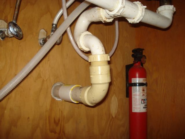

Erby Posted August 18, 2009 Report Share Posted August 18, 2009 Y'all ever been in one of them trick gravity house. This "S trap" is under a double kitchen sink. Click to Enlarge 37.52 KB AND it really is an "S"! Quote Link to comment Share on other sites More sharing options...
msteger Posted August 19, 2009 Author Report Share Posted August 19, 2009 Nice "S" trap.. it won't trap water but may trap a clog. Quote Link to comment Share on other sites More sharing options...
asihi Posted August 20, 2009 Report Share Posted August 20, 2009 Y'all ever been in one of them trick gravity house. This "S" trap is under a double kitchen sink. Click to Enlarge 37.52 KB AND it really is an "S"! I'm not sure I'd even call it a trap. At least a typical "S" trap will hold water. Not this one. Quote Link to comment Share on other sites More sharing options...

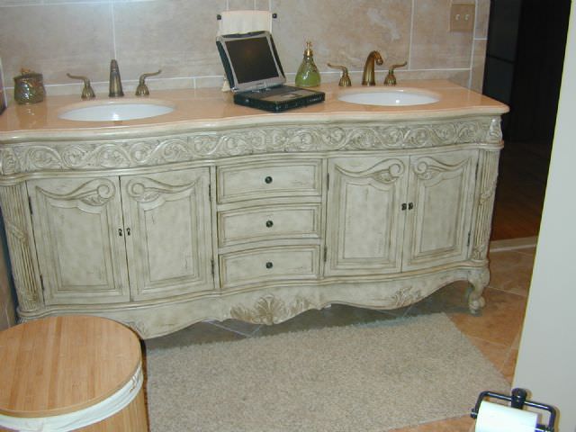

Kyle Kubs Posted August 20, 2009 Report Share Posted August 20, 2009 Ok, if we're doing the Larry, Mo & Curly plumbing work contest, I just had the prizewinner yesterday. Never would have expected to open this vanity Click to Enlarge 49.07 KB And find this masterful work of art. Click to Enlarge 29.99 KB Maybe that's what it was, some sort of "abstract engineering". Even better, this same handy homeowner did tons of electrical modification/additions including the power to the hot tub and swimming pool. Quote Link to comment Share on other sites More sharing options...
