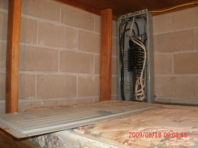

Phillip Posted August 26, 2009 Report Share Posted August 26, 2009 Walked into the room and seen this. Click to Enlarge 46.95 KB Bunk beds built in Quote Link to comment Share on other sites More sharing options...

resqman Posted August 27, 2009 Report Share Posted August 27, 2009 Top of panel cannot be more that 6'8" above the floor. Required to have 30x36 clearance in front of panel. Looks like at least a few things to write up. Quote Link to comment Share on other sites More sharing options...
Bill Kibbel Posted August 27, 2009 Report Share Posted August 27, 2009 Top of panel cannot be more that 6'8" above the floor. What's that from? You sure the maximum height doesn't refer to the highest device handle in a panelboard? Quote Link to comment Share on other sites More sharing options...
resqman Posted August 27, 2009 Report Share Posted August 27, 2009 I was wrong. It is 6'5" not 6'8". I thought it was the same height as doorways. E3305.2 Working clearances for energized equipment and panelboards. Except as otherwise specficied in Chapters 33 thorugh 42, the dimension of the working space in the direction to panelboards and live parts likely to require examination, adjustment, servicing or maintenance while energized shall be not less than 36 inches (914 mm) in depth. Distances shall be measured from the energized parts where such parts are exposed or from the enclosure front or opening where such parts are enclosed. In addition to the 36-inch dimension (914 mm), the work space shall not be less than 30 inches (762 mm) wide in front of the electrical equipment and not less than the width of such equipment. The work space shall be clear and shall extend from the floor or platform to a height of 6.5 feet (1981 mm). In all cases, the works space shall allow at least a 90-degree opening of equipment doors or hinged panels. Equipment associated with the electrical installation located above or below the electrical equipment shall be permitted to extend not more than 6 inches (152 mm) beyond the front of the electrial equipment. E3305.3 Dedicated panelboard space. The space equal to the width and depth of the panelboard and extending from the floor to a height of 6 feet (1829 mm) above the panelboard, or to the structural cieling, whichever is lower, shall be dedicated to the electrical installation. Piping, ducts, leak potection apparatus and other equipment foreign to the electrical installation shall not be installed in such dedicated space. The area above the dedicated space shall be permitted to contain foreign systems, provided that protection is installed to avoid damage to the electrical equipment from condensation, leaks, and breaks in such foreign systems., (see Figure E3305.1). E3305.7 Headroom. The minimun headroom for working spaces for service equipment and panelboards shall be 6.5 feet (1981 mm). Quote Link to comment Share on other sites More sharing options...
Jim Port Posted August 27, 2009 Report Share Posted August 27, 2009 Those dimensions as posted by Bruce are not in agreement with the NEC. The NEC allows the middle of the highest operating handle to be 6' 7", 2 meters above the floor. Quote Link to comment Share on other sites More sharing options...
Bill Kibbel Posted August 27, 2009 Report Share Posted August 27, 2009 Bruce, you're quoting minimum height of "working space". It doesn't back up your claim for the maximum height of panelboards. Jim P is correct, as per what's in the NEC and IRC. Quote Link to comment Share on other sites More sharing options...
resqman Posted August 27, 2009 Report Share Posted August 27, 2009 Bruce, you're quoting minimum height of "working space". It doesn't back up your claim for the maximum height of panelboards. Jim P is correct, as per what's in the NEC and IRC. Could you please reply with the specific sections numbers of NEC and IRC? I have both and would be happy to review to learn more about the error of my ways. I agree what I posted is the min. working space, which is revalent to the picture in the original post. Quote Link to comment Share on other sites More sharing options...

Bill Kibbel Posted August 28, 2009 Report Share Posted August 28, 2009 Bruce, you're quoting minimum height of "working space". It doesn't back up your claim for the maximum height of panelboards. Jim P is correct, as per what's in the NEC and IRC. Could you please reply with the specific sections numbers of NEC and IRC? I have both and would be happy to review to learn more about the error of my ways. I agree what I posted is the min. working space, which is revalent to the picture in the original post. I have the 2006 IRC here on my PC. The NEC is on my laptop in the car. IRC E3605.7 Location of overcurrent devices in or on premises. Overcurrent devices shall: 5. Be installed so that the center of the grip of the operating handle of the switch or circuit breaker, when in its highest position, is not more than 6 feet 7 inches (2.0 m) above the floor or working platform. Quote Link to comment Share on other sites More sharing options...
Richard Saunders Posted August 28, 2009 Report Share Posted August 28, 2009 5. Be installed so that the center of the grip of the operating handle of the switch or circuit breaker, when in its highest position, is not more than 6 feet 7 inches (2.0 m) above the floor or working platform. The top bunk.[:-taped] Quote Link to comment Share on other sites More sharing options...
