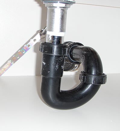

Ken Meyer Posted September 17, 2009 Report Share Posted September 17, 2009 Is there any requirement that a trap has to be removable for cleaning? This one is tight against the bottom of the cabinet. Couldn't find anything in Code Check that addresses this. Yes, I know the sink stopper arm is disconnected. Click to Enlarge 21.04 KB Quote Link to comment Share on other sites More sharing options...
Acorn Home Posted September 18, 2009 Report Share Posted September 18, 2009 That looks like it's removable... difficult but possible. Remove the nut on the right side, loosen the nut on left, rotate, tilt, swear, slide and you've got it... Quote Link to comment Share on other sites More sharing options...
Tom Raymond Posted September 18, 2009 Report Share Posted September 18, 2009 I think I'd have to swear at least 4 more times than that...and don't forget the towel to mop up the mess[:-banghea Tom Quote Link to comment Share on other sites More sharing options...
