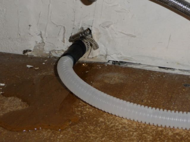

Robert Jones Posted September 23, 2009 Report Share Posted September 23, 2009 From today's condo inspection. Water supply for the dishwasher. Click to Enlarge 38.67 KB Quote Link to comment Share on other sites More sharing options...
sirch Posted September 23, 2009 Report Share Posted September 23, 2009 Good catch! Quote Link to comment Share on other sites More sharing options...

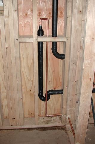

plumber jeff Posted February 1, 2011 Report Share Posted February 1, 2011 That is a johnson tee dishwasher drain. http://www.askmehelpdesk.com/attachment ... 1277248929 I recommend them on all houses i plumb where the ks and dw is on a exterior wall. make sure that the 3/4 pvc cap on the outside of the house has a hole drilled in it to work as a vent. During testing of the dwv system that cap is glued on. most i see even on old houses they are not drilled. http://www.terrylove.com/images/johnson_tee_2.jpg Quote Link to comment Share on other sites More sharing options...
