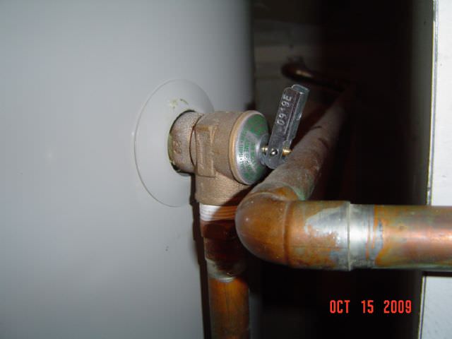

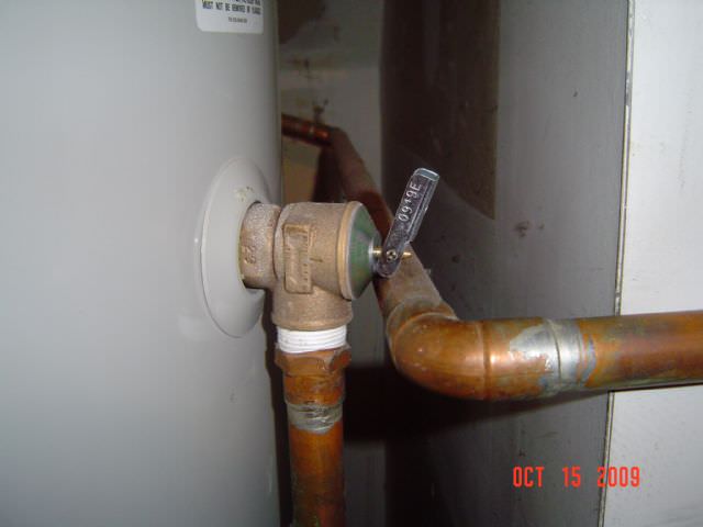

fox65 Posted October 16, 2009 Report Share Posted October 16, 2009 I am new homeowner, and am not inspector. I will appreciate if you guys look at the pictures and tell me if this is a problem. We had inspection, and after that previous owner replaced water heater. I did not have inspection after that and just now saw how pressure relief valve is installed. Its so tight against of heating pipe that small handle on the top could not move a bit. Sorry to bother you, but I did not find any info how it has to be install properly. Thank you in advance. Click to Enlarge 24.55 KB Click to Enlarge 26.04 KB Quote Link to comment Share on other sites More sharing options...
randynavarro Posted October 16, 2009 Report Share Posted October 16, 2009 If you go to the hardware store and find a T & P valve, read the instructions. It will say that you'll need to test that valve every year or so. You won't be able to operate that lever to test it. It's a bad install. Tanks are reeeaaal heavy when they're full but if you emptied it a bit, is there room to scoot it over or rotate it so the valve is free? If there is, just make sure you won't bust a pipe. Hopefully, they used flex connectors on the top of the tank to give you some wiggle room. Quote Link to comment Share on other sites More sharing options...
Terence McCann Posted October 16, 2009 Report Share Posted October 16, 2009 When the valve needs to open due to an over temp/pressure situation that pin, that the handle is attached to, will rise. If the copper pipe is blocking it from doing so then it is a safety issue and should be corrected ASAP. Quote Link to comment Share on other sites More sharing options...
hausdok Posted October 16, 2009 Report Share Posted October 16, 2009 It's obviously a case of a mildly retarded installer. I'd call his boss and insist he get his butt back there to correct it. ONE TEAM - ONE FIGHT!!! Mike Quote Link to comment Share on other sites More sharing options...
Erby Posted October 16, 2009 Report Share Posted October 16, 2009 I don't see the problem. In the second picture the pin is clearly OVER the copper pipe and should be able to operate freely. I agree, it's not an ideal install but the pin can move. Quote Link to comment Share on other sites More sharing options...
Jim Katen Posted October 16, 2009 Report Share Posted October 16, 2009 A firm downward tug on the copper pipe and the problem is solved. - Jim in Oregon Quote Link to comment Share on other sites More sharing options...
Darren Posted October 17, 2009 Report Share Posted October 17, 2009 Is there a sticker from the company who installed the unit? If there's a sticker from the company, call and tell them about the situation. Chances are they'll come back and correct it if you say you're going to call the township. If they refuse, call the township construction department and ask for a re-inspect and show them your concern. Also; I don't know if there was one previously, but a bonding jumper needs to be installed on the hot & cold pipes. Check that out too! Quote Link to comment Share on other sites More sharing options...
