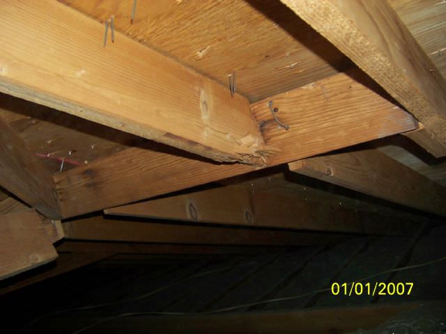

esch Posted October 19, 2009 Report Share Posted October 19, 2009 The house was re-roofed 3-6 weeks ago and when decking was replaced they used OSB and no H-clips between rafters (2' centers) Also found this rafter patch, just no sure what its for/from. Click to Enlarge 40.17 KB Quote Link to comment Share on other sites More sharing options...
Brandon Whitmore Posted October 19, 2009 Report Share Posted October 19, 2009 You would have to take note of the size of the sheathing to determine whether edge support/ H clips were required. Some may argue, but replacing sheathing is a structural modification that should probably have had permits pulled. That framing looks like crap. Quote Link to comment Share on other sites More sharing options...

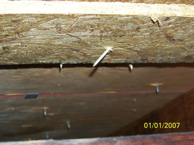

esch Posted October 19, 2009 Author Report Share Posted October 19, 2009 You would have to take note of the size of the sheathing to determine whether edge support/ H clips were required. Some may argue, but replacing sheathing is a structural modification that should probably have had permits pulled. That framing looks like crap. The orginal roof sheathing was CD the replacement was OSB, H-clips were used on original, so I will note it as missing H clips =) I can also push on the osb and make it flex with minimal effort (20 pounds force?) Quote Link to comment Share on other sites More sharing options...
Brandon Whitmore Posted October 19, 2009 Report Share Posted October 19, 2009 The orginal roof sheathing was CD the replacement was OSB, H-clips were used on original, so I will note it as missing H clips =) You can do so, but if they are not required, you will lose credibility by calling something out that is not an issue. Just my opinion. Quote Link to comment Share on other sites More sharing options...
Brandon Whitmore Posted October 19, 2009 Report Share Posted October 19, 2009 Hi Matt, Read this: http://www.tecotested.com/techtips/pdf/tt_edgeclips Also, building code books will tell you exactly when edge support is required. I can also push on the osb and make it flex with minimal effort (20 pounds force?) This is covered in the above article.... Quote Link to comment Share on other sites More sharing options...
esch Posted October 19, 2009 Author Report Share Posted October 19, 2009 Hmm valid point =) Although not every joint is "scabbed", some are They knew it needed them during installation though =) Click to Enlarge 50.23 KB Matt Interesting piece of material, another example of why yall are so helpful to beginners like myself, thanks again. Quote Link to comment Share on other sites More sharing options...
Brandon Whitmore Posted October 19, 2009 Report Share Posted October 19, 2009 I recommend that you go here: http://www.apawood.org/ and read everything they have to offer. It's a great resource-- signing up is free. Quote Link to comment Share on other sites More sharing options...
