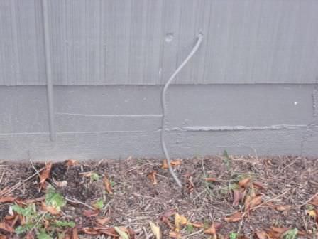

Ponyboy Posted November 5, 2009 Report Share Posted November 5, 2009 I need some LP gas line help. This installation was in the city which is pretty rare for LP in my area. The LP gas line on the exterior of the house consists of 1/2" copper tubing loosely running down the side of the house into the ground. The driveway also exists on this side of the house. The pipe appears to go under the driveway to the storage tank. Standard black iron piping was used inside of the house. This pipe looks improperly installed, but I can't find ant pipe installation guidleines in NFPA-58. I think the piping should be black iron into the ground with some car protection. I am also posting in the HVAC forum. Click to Enlarge 25.77 KB Click to Enlarge 22.35 KB Quote Link to comment Share on other sites More sharing options...
Tom Raymond Posted November 5, 2009 Report Share Posted November 5, 2009 That pretty much looks like every LP set up I've ever seen. Tom Quote Link to comment Share on other sites More sharing options...
Jack Ahern Posted November 6, 2009 Report Share Posted November 6, 2009 That is what they do in Maine! Scares me-but not the gas installers????[:-banghea Quote Link to comment Share on other sites More sharing options...
Jim Katen Posted November 6, 2009 Report Share Posted November 6, 2009 That's normal out here too. I'm sure I've described this before, but my neighbor lost a whole tank of propane when her dog bit through the copper line. - Jim in Oregon Quote Link to comment Share on other sites More sharing options...
esch Posted November 7, 2009 Report Share Posted November 7, 2009 Normally in East Texas, black iron would stub outside of house with a valve, followed by yellow flex going underground to propane. But propane suppliers in my area also said tanks had to be 14' from the house minimum or the gas company would not fill the tank. They also inspected gas fixtures inside before the first filling. Matt Quote Link to comment Share on other sites More sharing options...
Ponyboy Posted November 7, 2009 Author Report Share Posted November 7, 2009 Thanks for the feedback. I wrote up the lack of an impact protection post at the exposed LP pipe. Gas meters and piping are required to have protection when adjacent to a driveway, so I figure the LP line should as well. Quote Link to comment Share on other sites More sharing options...
resqman Posted November 8, 2009 Report Share Posted November 8, 2009 Can you post an IRC reference regarding the required impact protection please? Quote Link to comment Share on other sites More sharing options...
