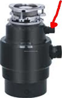

Phillip Posted December 24, 2009 Report Share Posted December 24, 2009 I read some where that there is a knock out where the dishwasher drain line connected to the disposal. I did a search here and did not find anything about it. Would some one info me about this and does anyone have a photo of this. Thanks and I hope you all have a Merry Christmas. Quote Link to comment Share on other sites More sharing options...

Erby Posted December 24, 2009 Report Share Posted December 24, 2009 Phillip. Think aobut it. Not all garbage disposers have a dishwasher connected to them. Those that do are connected to the tail piece designed to accept the dishwasher hose. Inside that tailpiece is a knockokut (seal) that keeps the disposer from leaking if a dishwasher is not connected to it. When you hook a dishwasher to that tailpiece, that seal (knockout) has to be removed to allow water to flow through the tailpiece. When the knockout is NOT removed there's no place for the water from the dishwasher to go. It leaks out of the hose connection to the disposer. Ask me how I now this???? Distraction can make a mess! I just use a screwdriver to knock it into the disposer and then turn the disposer upside down so it falls out. THEN reinstall the disposer. It's easier if you do it BEFORE it makes a mess. It's inside the tailpiece at the arrow. Click to Enlarge 9.08 KB Quote Link to comment Share on other sites More sharing options...

Brandon Whitmore Posted December 24, 2009 Report Share Posted December 24, 2009 I just use a screwdriver to knock it into the disposer and then turn the disposer upside down so it falls out. That's how the smart people do it. The last time I installed one I forgot to pop the plug out until it was already installed. Women and their small hands have their uses[:-slaphap Merry Christmas everybody. Quote Link to comment Share on other sites More sharing options...
