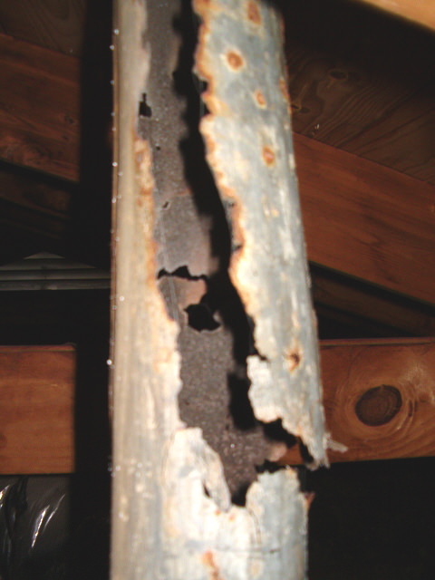

Jaykline Posted November 15, 2004 Report Share Posted November 15, 2004 I found this surprise during an inspection yesterday. Top portion of a propane fueled water heater. Bottom portion looked ok. House had just been re-roofed - new flashing for everything including this. I guess the roofers didn't have the time or the desire to point it out. House is 30+ years old. WH is 12. Download Attachment: WH vent 2.JPG 127.93 KB Download Attachment: WH Vent 3.JPG 158.59 KB Quote Link to comment Share on other sites More sharing options...
hausdok Posted November 15, 2004 Report Share Posted November 15, 2004 Well, For, those new to the biz, that's a great illustration of one of the reasons why one is prohibited from using a single-walled vent in unconditioned space. ONE TEAM - ONE FIGHT!!! Mike Quote Link to comment Share on other sites More sharing options...
Jack Ahern Posted November 15, 2004 Report Share Posted November 15, 2004 For the new guys--you need to get up in the attic and walk around (if safety permits).You need adequate light,proper training, enough time to fully inspect the attic area, and the confidence to red flag it. Missing something like that, will cost some one their health or a life.That exhaust will find its way into the living space. The owners will never know what hit them [:-banghea Jack Ahern Needham on the Charles Quote Link to comment Share on other sites More sharing options...
Bruce Thomas Posted November 15, 2004 Report Share Posted November 15, 2004 I hate to keep harping on attic fires but here is another one waiting to happen. Bruce Quote Link to comment Share on other sites More sharing options...
Brian G Posted November 16, 2004 Report Share Posted November 16, 2004 That's the kind of thing we have to catch. Genuinely serious, plainly visible, yet others have ignored it or not gone far enough to see it. Nice job Jay. Brian G. Extra Miles Bring Client Smiles [:-angel] Quote Link to comment Share on other sites More sharing options...
