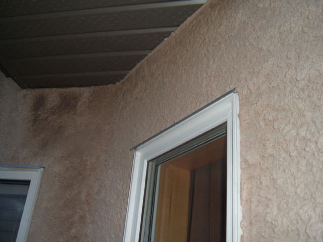

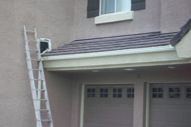

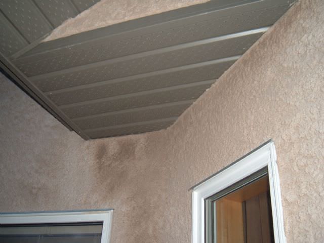

Hapless Handyman Posted June 9, 2010 Report Share Posted June 9, 2010 Good evening, I have a three year old home and water is dripiing from the top of the window casing. The flashing outside is dry. Any helpful comments appreciated. Click to Enlarge 25.26 KB Click to Enlarge 22.37 KB Click to Enlarge 39.71 KB Click to Enlarge 42.17 KB Quote Link to comment Share on other sites More sharing options...

Brandon Whitmore Posted June 11, 2010 Report Share Posted June 11, 2010 One more establishing shot from further back would be very helpful. Quote Link to comment Share on other sites More sharing options...
Rocon Posted June 11, 2010 Report Share Posted June 11, 2010 Is the window in question the smaller window under the eave? If so I see that the plaster is ground to the bottom side of the soffit. I would check to see if the soffit sheet metal is slightly canted toward the head of the smaller window. I believe your issue could be the confined rake diverter flashing (or lack of) above the larger window it could allow water in to the eave where it travels in the soffit and is deposited behind the Plaster WRB. the water travels behind the WRB, behind the nailing fin and flashings and then manifests at the head of the window. Similar condition in the photo below. Click to Enlarge 34.29 KB Click to Enlarge 55.05 KB Quote Link to comment Share on other sites More sharing options...
Tom Raymond Posted June 11, 2010 Report Share Posted June 11, 2010 You have a larger problem than just a little water leaking out of your window casing. The details on that EIFS installation are all wrong. You need to hire an EIFS Inspector to figure out just how screwed up the siding is and what needs to be corrected. He should be able to find the source of the water intrusion as well. Tom Quote Link to comment Share on other sites More sharing options...
Rocon Posted June 11, 2010 Report Share Posted June 11, 2010 You have a larger problem than just a little water leaking out of your window casing. The details on that EIFS installation are all wrong. You need to hire an EIFS Inspector to figure out just how screwed up the siding is and what needs to be corrected. He should be able to find the source of the water intrusion as well. Tom That is why I was there. And it is not EIFS, but similar system. Quote Link to comment Share on other sites More sharing options...
