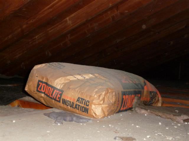

gtblum Posted June 21, 2010 Report Share Posted June 21, 2010 There was an insulation product called Zonolite that was quite common 60 odd years ago; it's vermiculite. The Loew's stuff has "certified asbestos free" on the bag. Still around in 1972. Click to Enlarge 36.79 KB Quote Link to comment Share on other sites More sharing options...
kurt Posted June 21, 2010 Report Share Posted June 21, 2010 S'funny.....I see bags of that stuff stuck in old attics every once and a while. For the general library, should someone not know, vermiculite is expanded mica. They pop the stuff in a giant popcorn popper....... Quote Link to comment Share on other sites More sharing options...
