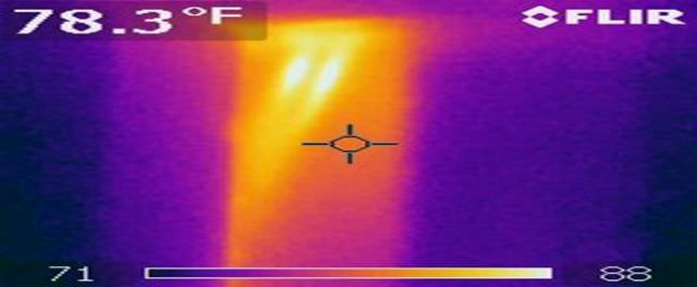

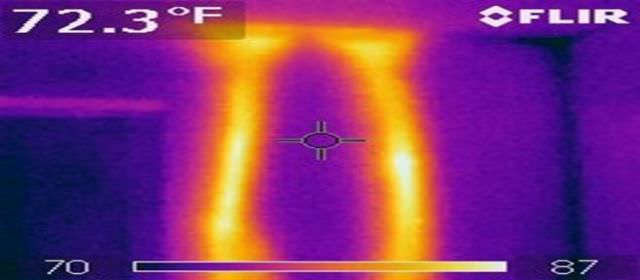

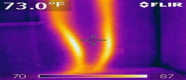

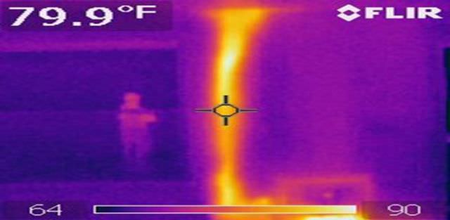

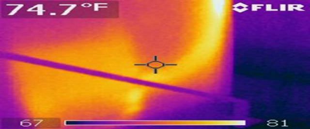

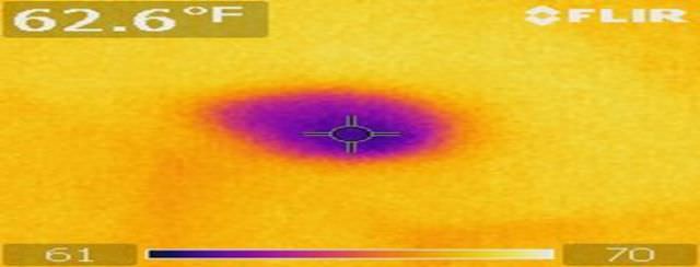

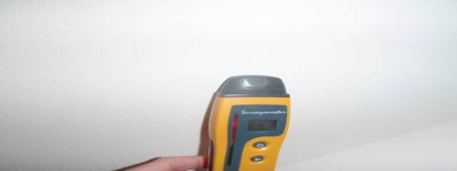

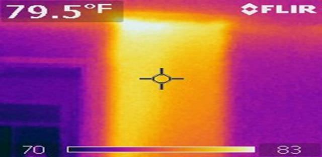

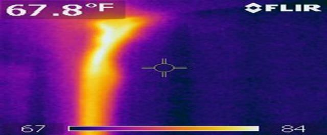

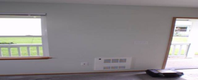

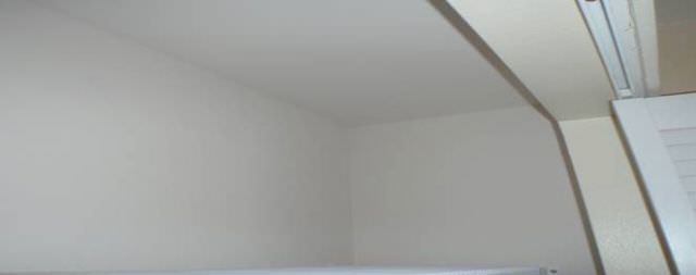

hausdok Posted July 4, 2010 Report Share Posted July 4, 2010 Hi All, I just dodged a bullet; more or less by accident. About six weeks ago I inspected a little modern cottage house for a lady. It's on a slab and heated with a bio-radiant heating system with in-wall forced hot air hydronic heaters. The water heater sits in a plastic overflow pan in a closet on the second floor. Whenever I inspect one of those homes, I always tell the client to try and find out where the PEX is located in the walls and ceilings, so that they don't accidentally puncture one of the lines while hanging pictures after they move in; either by talking to the mechanical contractor that did the job or by having a thermographer come out, turn the heat up to full and then scan the walls. Well, she did just that. About a week or so ago she called me to ask for some recommendations and asked me whether I saw an issue with one of my competitors that uses IR technology. I gave her some names and told her that the guy had a good rep locally. Today I got an email. They'd done the inspection Thursday. Everything looked good until they scanned the interior of the pantry below the mechanical room where the IR camera revealed a damp spot. They cut a hole in the drywall; yep, the water heater is leaking above and apparently the pan is cracked under the water heater. She's got a pail catching the drip right now. Jeez, what are the odds that my own recommendation to just do something extra as an optional precaution would accidentally uncover something like this? No indication at the ceiling of that pantry of any issues at the time of the inspection and all of the walls were dry. I did not get up on a ladder to check the ceiling - maybe I should be doing that when there's a bathroom or mechanical room above, but in more than 14 years this is the first time I can remember something like this nearly biting me. She's not mad. She realizes I don't have X-ray vision; but not all clients are so understanding or even want to be so understanding. Anyway, it's got me more than ever seriously considering the leap to IR. Check out the photos below; especially the last three. ONE TEAM - ONE FIGHT!!! Mike Click to Enlarge 13.87 KB Click to Enlarge 21.93 KB Click to Enlarge 18.8 KB Click to Enlarge 9.59 KB Click to Enlarge 19.48 KB Click to Enlarge 20.02 KB Click to Enlarge 11 KB Click to Enlarge 21.99 KB Click to Enlarge 21.16 KB Click to Enlarge 10.95 KB Click to Enlarge 18.96 KB Click to Enlarge 20.65 KB Click to Enlarge 13.4 KB Click to Enlarge 22.08 KB Click to Enlarge 10.96 KB Click to Enlarge 19.86 KB Click to Enlarge 19.25 KB Click to Enlarge 8.93 KB Click to Enlarge 18.35 KB Click to Enlarge 10.19 KB Quote Link to comment Share on other sites More sharing options...

Chris Bernhardt Posted July 5, 2010 Report Share Posted July 5, 2010 The IR cam does come in very handy for finding certain types of leaks that are otherwise not going to be easy to find. What are you going to do, scan the whole house with an SM? Even if you did, you'll still miss some leaks because the SM doesn't scan deep enough, and the anomalies that you do find, without any other supporting evidence, will make your head ache trying to figure out if they are a problem or not. When you get an IR camera, you'll probably spend the first year doing complete scans. After a while, you'll find that a waste of time given your knowledge about buildings and where and when leaks are likely to be detected. Chris, Oregon Quote Link to comment Share on other sites More sharing options...
kurt Posted July 6, 2010 Report Share Posted July 6, 2010 After a while, you'll find that a waste of time given your knowledge about buildings and where and when leaks are likely to be detected. Chris, Oregon That's what I'm finding. Doing complete scans is sorta goofy in some ways; I mean, what are folks looking for? Knowing what I know after 6 months, honestly, if I had it to do all over again, I'm not altogether sure I'd buy in. There's been a half dozen revelation moments, that upon consideration, I could have found without IR if I'd been diligent. Then again, diligence ebbs and flows depending on all sorts of considerations, distractions, red herrings, etc. One thing for sure; folks think it's the coolest thing in the world. They stand around awestruck. Especially when you show them the location of radiant heat tubing in the floor. It even makes obnoxious overbearing 'zoids shut up. Which, upon reflection, may make it a worthwhile investment. Quote Link to comment Share on other sites More sharing options...
hausdok Posted July 6, 2010 Author Report Share Posted July 6, 2010 Hi, It's kind of grainy, but she sent me a photo of the leak once they'd opened it up. It looks like they've installed an access panel. It's hard to see where it's coming from. Looks to me the leak is coming from the pipe elbow but it might just be draining off of something from above and dripping off the elbow. She says she's accumulated about 1/4-cup of water since Friday. The spot in the photo is pretty small. Either it's very recent or there was so little that it's simply been evaporating as quickly as it's dripped onto the drywall. ONE TEAM - ONE FIGHT!!! Mike Click to Enlarge 27.08 KB Quote Link to comment Share on other sites More sharing options...
kurt Posted July 6, 2010 Report Share Posted July 6, 2010 Every once and a while, I find teeny tiny leaks in copper joints. One thing you learn with IR; it's not the magic machine the vendors and TV shows make it out to be. It may or may not have "found" this leak. Quote Link to comment Share on other sites More sharing options...
