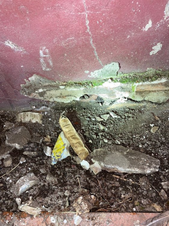

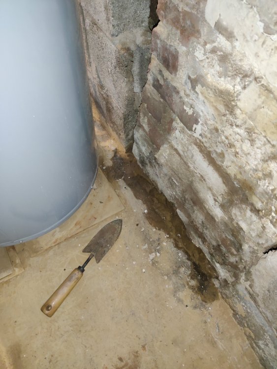

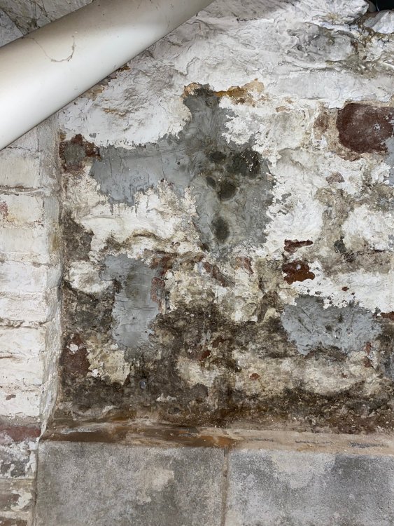

  1. Sorry for the delay in my response. I had seen your reply, kept meaning to respond, but it kept slipping my mind. The contactor showed up, and didn't recommend a sump. He essentially said exactly what you did in this post. He said he doesn't think the basement was dug out. The cinderblock wall was one for just hiding things and quick fixes rather than addressing the problem. You should see some of the other stuff we found while we were doing basic renovations!
