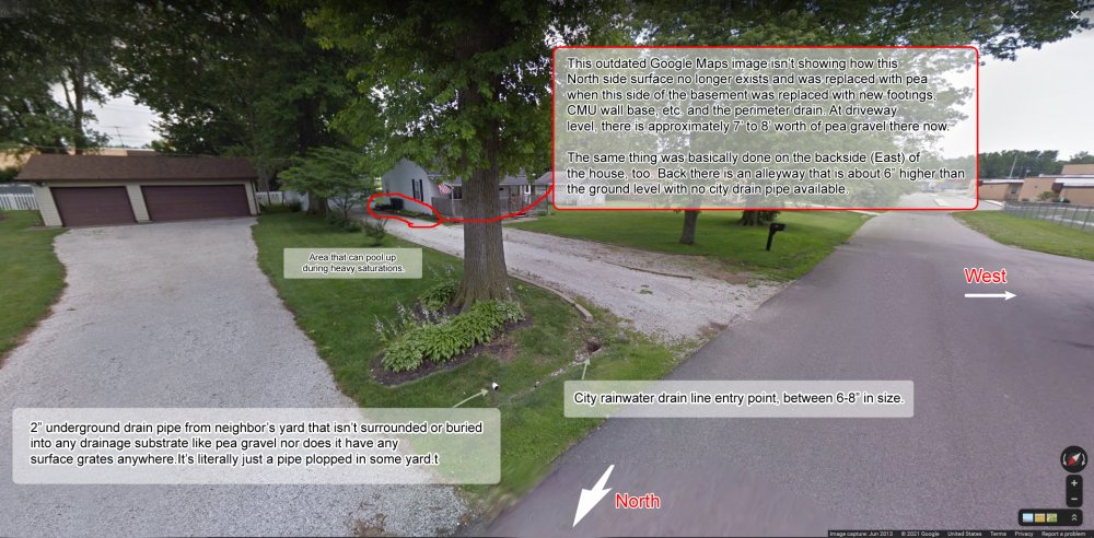

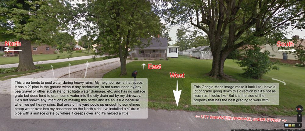

Pretty much. Looking at it from the outside, you wouldn't really think it because it doesn't show an obvious bowl landscape but once you see how water behaves during rains, you realize it needs grading but because of the property itself, it's just not very possible. The closest I might be able to do is take down a tree by the city street and then bulldoze the heck out of the land to grade down the street direction, but I'm not convinced it would be impactful enough to merit the money and effort. I've attached 2 images: both basically show the house and the land it sits on. I'll try to find one that shows the rear of the home and lot, but these two might give you an idea of what I'm up against. The South face has the best options where grading is concerned but considering how my perimeter drain sits basically 7-8 feet below the driveway level, it's somewhat moot from what I can tell, which is why we decided to bring the water into the basement to be pumped out to the city rainwater drainage (the 2" discharge pipe currently runs through some crawlspace and travels underground from under the add-on master bedroom on the South side of the home). Both images I was able to grab from Google Maps but neither show the 20' 4" solid PVC downspout extensions I currently have attached to the downspouts, with one being on the South corner of the porch and 2 being behind the home on the East side. The place that I get the most water is right there on the North-West corner: water tends to come in at a corner in the basement where the old wall meets up with new. Some of this is because the contractor made no effort to compact dirt or cement anything where the old block was exposed which runs underneath the porch. Instead, they simply dumped pea gravel down into the trench after putting a thin layer of tar sealer on their new walls whereby their masonry guy tried to seal everything as well as he could from the inside using some cut-to-size CMU along with mortar. So it's no surprise that water comes in right there and I'm currently trying to get a quote about how much it would cost to dig up the pea gravel and redo that as a worst-case approach, but it still wouldn't do anything about the water coming in as there's nothing that I think can be done about it from the outside.

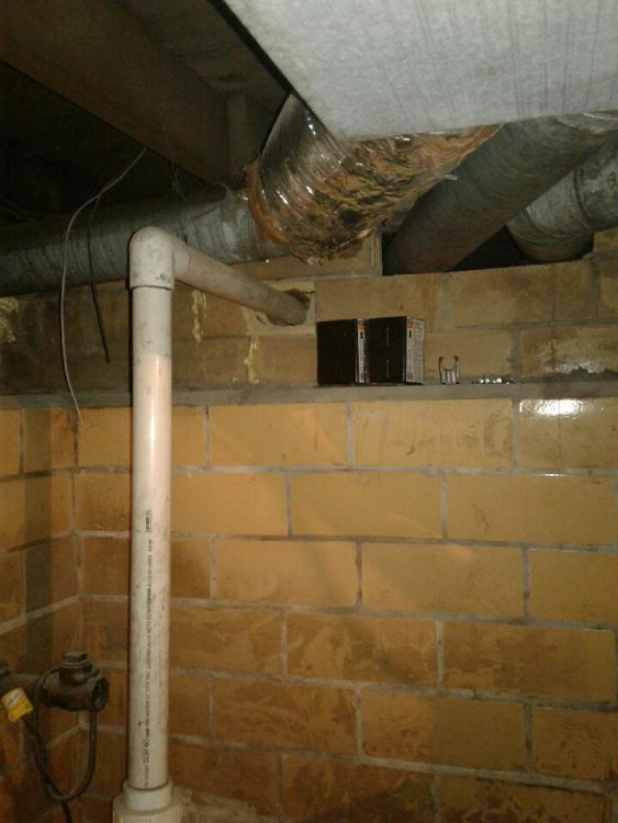

So I'm on the verge of pursuing a basement drainage system which uses weep holes. It's basically your typical French drainage along each wall where it drops into a trench some perforated pipe at the footer's edge and on top of that is pea gravel followed by a drip board that encapsulates both the trench as well as about 4-6 inches worth of wall after weep holes have been drilled into the block. The bad thing about my basement is that it has a few walls that were built with what I understand as being "structural clay block," which have horizontal voids. I believe these have been "kiln fired" (see attached image and judge for yourself). The house is an older home, likely built back in the 20s or 30s and this unfinished basement was dug-out after the home was built, which is one reason these blocks might've been used. The contractor who will be doing the work seems confident that drilling into this kind of block is a simple issue and he didn't seem to expect any problems in doing it. I have 2 other walls that were recently built back in November with your common CMU block and I'm not worried about him drilling the holes into those, it's just these older clay blocks I'm worried about. My fear is that he (or his team) could either use the wrong bits or improper technique, whatever, and cause a confluence of failures forcing me to replace an entire wall. Is it worth the risk? My heart of hearts says "no," but I'm so tired of worrying about rainwater in my basement that I'm close to taking the gamble anyway. Thing is, my yard lacks necessary height to properly grade it, so there's no options with any landscaping beyond what I've already tried to do (add berm against house, etc.). I've already extended my downspouts 20+ feet out from the house with solid PVC pipe, which did help a little. The new CMU walls that were installed this past November are the only walls that have a real perimeter drain. This drain line is connected to one of my sump pumps (I have 2). The drain line itself sits on top of the footer (the contractors didn't put it at the edge, but the top of the drain pipe is below the bottom block of the new walls by at least a couple inches and it's a 4-inch corrugated-perforated black drain pipe that was used). The perimeter drain does work, both pumps pump like crazy during heavy rains, but I just get seepage along the cold / cove joints and corners where the new walls meet up with the old. Through discussions, I've been told that it can be dealt with using this interior drain system / weep hole approach, but drilling into those clay blocks keeps me up at night. Would love to know if you think it's doable... Thanks in advance.

That came up and when I brought it up to my neighbor, he seemed to be a little sour about it for fear of water being backed up into his yard. Thing is, it's HIS water anyway, so it's like he's more concerned about me preventing HIS water from being allowed to come over into mine instead of him being a responsible home owner and dealing with his drainage problems... He can be pretty irritating sometimes about things like this but when he's not being this way, he's a great neighbor. So yeah, the berm would mean that some of this would be on his property line to make it work, so I think that's a dead-end but what I think I'm going to do is this (which is best of both worlds): Along that location--which is where the water enters into my driveway--there's already a pre-existing concrete divider. It's basically just an old and long curb boundary that someone installed years ago. It's not very pretty, has cracks and low-spots near where the water crossed over, so it doesn't block any of that water once it reaches a certain height. So after I spoke to a concrete guy this weekend, I'm going to replace it with a much higher and deeper boundary next spring. The main part I need will be on my property per a property stake I found yesterday but there's a small 4-5 foot length right on front of my garage that does a 45-degree angle to meet my garage's Northern-most edge. According to my neighbor, the previous home owner apparently built the garage with about 2 or 3 feet of garage being on my neighbor's plot. Judging from the property stake (unless he put the stake there while I wasn't looking!) I think he's right. So what this means is that for the main length of the area where water creeps over, I'll be okay to do the new concrete boundary because that's on my property but for the part closest to my garage, I might have issues with the neighbor but I doubt it since there's already boundary rocks there that I use to lay down a boundary for my driveway. I plan on speaking to him about this once the time comes to do the work but I'll be fine for the main part I need the concrete divider for where the water comes over. But once I get done with this divider, I'm going to grade the driveway down as much as possible. I kind of think I should grade everything first but I don't want to lower the area any that might be blocking water as-is. I'll try to post an image of what everything looks like at. I'm at work right now but I'll try to do that later. -

I had thought about adding a simple surface grate opening (like this one from Menards: https://www.menards.com/main/plumbing/water-systems/landscape-drainage/catch-basins-grates/nds-reg-3-4-plastic-round-grate-green/m13u/p-1534141687657-c-8633.htm?tid=-7052075211146383363&ipos=1) right in the yard where the water begins to pool up but close enough on my side of the yard to avoid problems with the neighbor, and connect it to my drain line that I was going to connect to the city rainwater trunk by the road. It's not a box drain but it's at least an entry point that wouldn't become compacted or stopped by the gravel in the driveway. Are there any grate systems I could install directly in my driveway? I was thinking about installing one of these somewhere near the pool-up area but in the driveway and not in a section that undergoes a lot of traffic: https://www.menards.com/main/plumbing/water-systems/landscape-drainage/catch-basins-grates/nds-reg-9-x-9-catch-basin-with-grate/900gkit/p-1534141687510-c-8633.htm?tid=-4079200001551132842&ipos=8 Sorry, but I'm sold on the adding the external sump pump in all this at some point. I just don't think there's enough grade to make everything gravity-based and when it rains hard, having it be involved would be too helpful not to have. The location I would install it at would be within proximity to an external power receptacle, leaving the only complexity left to worry about being the actual install and connection of the pipes, which I can handle if it comes down to me doing it but that depends on the other outfits I have coming out to give me options between now and the next couple weeks, too. -

I live in a home that experiences fairly bad drainage issues during bad saturations or heavy rains and I'm trying to get ahead of it by attacking my driveway with better drainage... You see, my driveway is one of the worst areas where a lot of water tends to move over from my neighbor's yard (who is either unwilling or unable to do much about it from his area). The bad thing is that much of this water makes its way into my home's old basement, which causes all sorts of problems. I have plans in motion to deal with that this coming January but in the meantime, I want to do whatever I can about the external stuff. So I spoke to an excavation guy in my town about the possibility of installing a 6" PVC drainage system underneath my entire driveway. Basically, my idea consists of laying down multiple "fingers" of this pipe along the length of my driveway (maybe 4 fingers, total) and in the future, connecting those fingers to an external sump pump that would also be in a special spot of the driveway to maximize its efficiency. I'd like to lay down a thick vapor barrier underneath each finger for added capture capabilities but initially rely on gravity alone to direct whatever these fingers catch so that the water would be moved into the town's rainwater trunk at the end of my driveway--I think I have enough grade to do that, especially given how that rainwater line is about 1.5 feet underneath the end of my driveway, easily enough to provide an 8th of an inch per-foot of decent for the 15 feet or so of distance that this would play in. Bear in mind that my driveway isn't paved or blacktopped, it's just a basic crushed lime rock base and the majority of its rocks are about half the size of a golf ball. Anyway, when I floated all this to the excavation guy, he said that it's possible the drainage PVC holes could get covered up once the gravel becomes compacted. This could lead to an ineffective drain system. He also advised against the external sump pump due to maintenance issues that sometimes come up... While I'm sure all of his considerations are 100% possible, my rationale for doing it despite his insights is that even if some of the holes get blocked up or even if the sump pump needs occasional maintenance, it would still result in a much better outcome than the one I'm currently banging my head against where the water just does whatever it wants. Sure, some of the drainage holes along the pipe my get covered but not all... And sure, the sump pump might give out at some point but not all the time. When we were discussing all this, he floated an idea about adding a box grate near the areas where water tends to pool up and just connecting that to a 6" pipe that connects to the rainwater trunk and said that the thought this would have a better impact than my idea. So I figure, why not just do both and have the best of both worlds? I'd first build out the 6" PVC finger drainage system (with the vapor barriers) and then after that, add the box grate or grates, and then sometime after that (once money gets built back up!), add an external sump pump to everything and connect that to the rainwater trunk. This sounds like a good idea, right? God, it can't hurt anything. I know it will be pretty expensive to do it all but in the end, once all the pieces are in play, I can't imagine that this wouldn't have an awesome impact. Any insights into this would be appreciated. I'm pretty convinced that this is what I'm going to do but thought I'd see if any of you have anything to add to this before I get started on it. Thanks in advance. ( I posted about this over on a different forum, too, so if I get any responses from there, I'll update this as a means of helping anyone else who might be a similar situation.)
