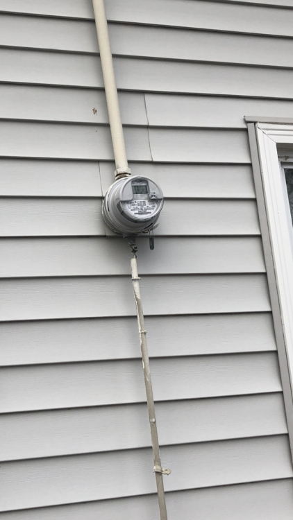

  1. Hey your right my bad it’s not the same exact panel I’m on the other side of the duplex with this photo , but okay makes sense the bare copper is the neutral and the equipment grounding conductor is bonded to the neutral at the meter instead of the panel
  2. I posted a pic awhile back of this panel without the cover taken off. Could someone help explain a few things for me, this is the main panel, there are two hot conductors coming in from the back and looks like a 6 gauge bare copper coming in that connects to the neutral bus. That bare copper wire I thought was the equipment grounding conductor but where’s the neutral? Is the copper wire the neutral but then we’re is there equipment grounding conductor? The bigger wire dropping straight down from the top is just to the dryer, and its a main lug only panel so no main disconnect, fewer than 6 movements to disconnect , and on the sec there’s just two sets bc it’s a duplex.

    Yeah your exactly right I googled main lug only panel and see what your talking about now, Will get some inside pics soon and post them, thank you
