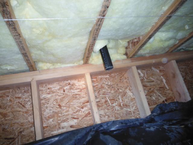

Could it be coming from the water heater drain pan? That is my first guess. I see them like that fairly often with 1 1/2 pipe. Maybe it's an extension.
The tank may be leaking, regardless of the faucets.

2001 (vacant for a couple months) home. Trying to figure out what this 2" ABS pipe is for. Old stains, standing water and dripping water from pipe after I ran a bunch of faucets in the home. It was near a bathroom, which was behind bearing wall... any ideas??

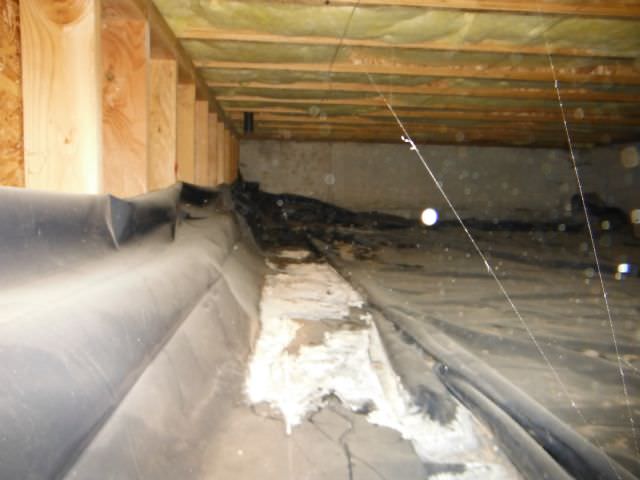

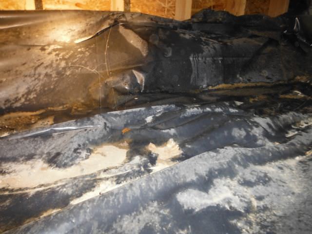

25 year old metal roof on shop. Visqueen is shot,

My recommendation was a metal roof contractor remove metal and install vinyl face insulation batt (don't know what they call that type of insulation material)
Anyone have experience with spray foam on inside in this situation as am concerned about with wood under the foam or will that ever be a trapped (moisture) problem if all is dry when applied??
