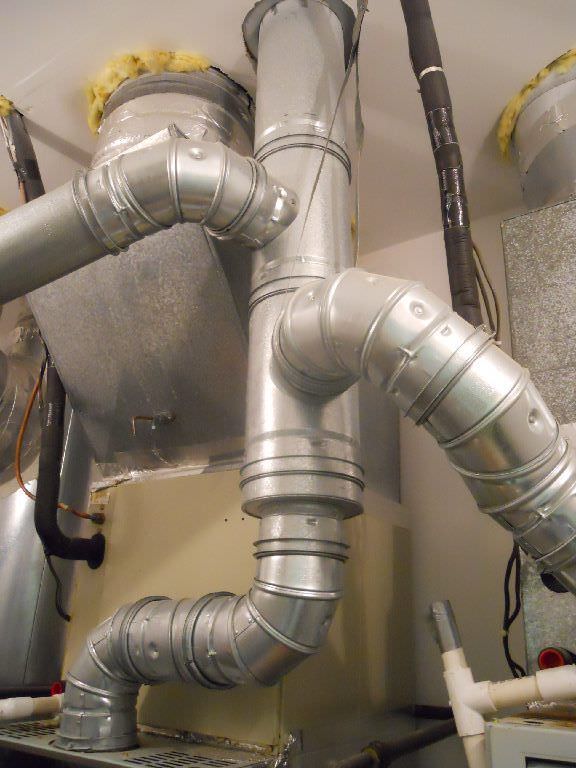

Here' one for the brain trust:
A 44,000 btu furnace with a draft inducing blower (right flue)
A 88,000 btu furnace with a draft inducing blower (center flue)
And a 75,000 btu gas water heater - gravity (left flue)
ALL share this flue. It seems to me that it should have stepped up another size after the third flue joined in. Undersized? Any thought?
69.73 KB
And, all three units are crammed into a 6 x 9 unvented room in the finished basement ... hmm....
