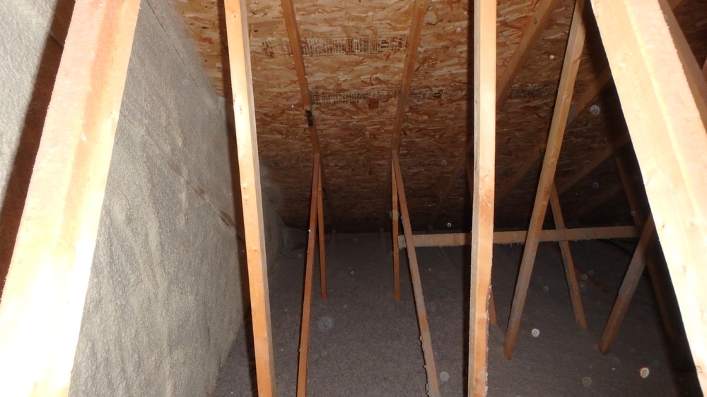

Maybe it's this? A kind of foam with an intumescent property. http://www.firechemicals.com/Firex.html I can feel the foam like density and insulation properties when I touched it in the attic. This product looks pretty interesting. I can see how thermal resistance is important. I may have answered my own question here.
It is definitely spray foam. It may have an intumescent latex barrier on it, but I'm not 100% sure if even that is considered ok. The building doesn't have sprinklers and it's a residential home. I think it would require a fire wall. This is just a new one on me. Wondering if anyone else has seen it or has an opinion on it? This is an intumescent latex barrier: http://www.netzerotools.com/handi-foam-m10000-ignition-barrier-5-gallon

Hello All, I just wanted to ask for some feedback. I did an inspection on a 2011 townhome and in the attic, there was spray foam over the party walls. There is a hole at the top of one party wall which I am asking to be sealed, but what are your views on the spray foam? How can it affect the fire rating of the wall? I did not make any holes to measure the drywall and verify a proper 5/8" . How would you write it up? Thanks in advance for any opinions you may have
