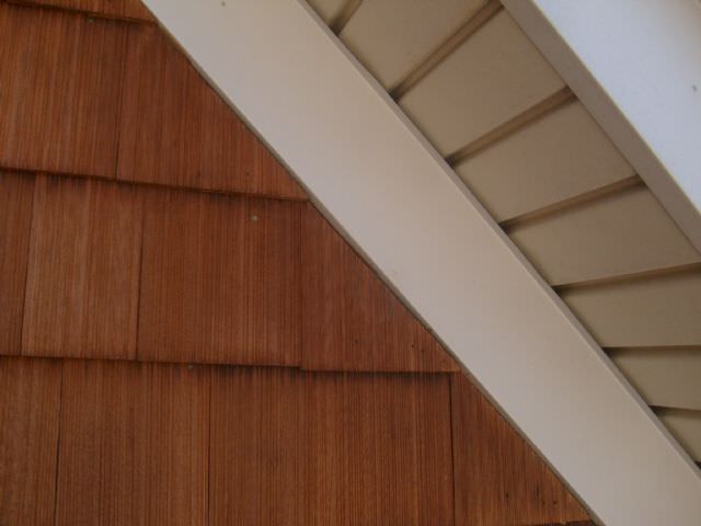

Tim Maxwell Posted February 26, 2010 Report Share Posted February 26, 2010 These wood shingles are installed in the front gables. Shouldn't there be trim overlapping the angled edge to prevent moisture entry. As you see, the shingles butt up against the trim. And of course the shingles have lots of face nailing. Click to Enlarge 29.82 KB Quote Link to comment Share on other sites More sharing options...
Brandon Whitmore Posted February 26, 2010 Report Share Posted February 26, 2010 Based on the picture alone, I don't think water will ever reach up there when it rains. That said, I wouldn't worry about it. If there was only a slight chance water would hit up there once in a great while, I'd recommend caulk. Quote Link to comment Share on other sites More sharing options...
