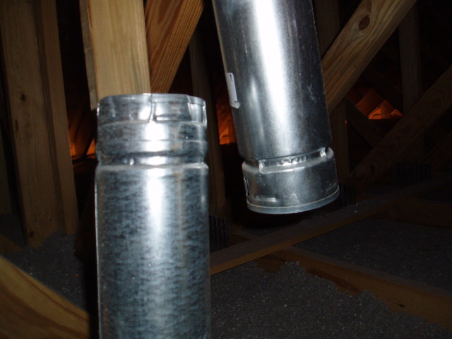

pi Posted November 14, 2006 Report Share Posted November 14, 2006 I did the pre-drywall and later final inspection on a new home for an elderly couple. The builder was a pain. Made me present license, proof of liability ins, etc. I did final, couple was to move in 2 days later. Builder (large nationwide) was done with their final "quality check" and all was well. The water heater was not installed during pre-dry but attic vent piping was in attic over garage and was easy to see at that point, OK. At my final, viewing would have been another matter, attic was way around corner from access hole, fresh deep blown in insulation, nowhere to step. But you know how it is, just gotta go there, don't ya. Well I went, and the water heater installer must have yank down so hard on the flue pipe to make it fit on his water heater, it came loose at a joint, and now it vents into attic. Lots of hot moist air to rot out everything not to mention CO and fire hazard. The couple would not have known until something bad happened and it would have. Builder's rep was like, "no big deal" we'll fix it. I got so mad, I wrote every government code and license board I could. Hope they get 'em. New construction here in the hot area around charlotte has really gone to the dogs. No question, I just needed to vent. No pun intended! Download Attachment: 061012ada 006.jpg 150.21 K Quote Link to comment Share on other sites More sharing options...

Scottpat Posted November 15, 2006 Report Share Posted November 15, 2006 That is also very common when a home has a new roof installed. Really is an easy fix. As for reporting the builder to everyone, I would have used that energy for something else. Quote Link to comment Share on other sites More sharing options...
