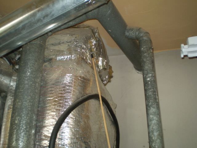

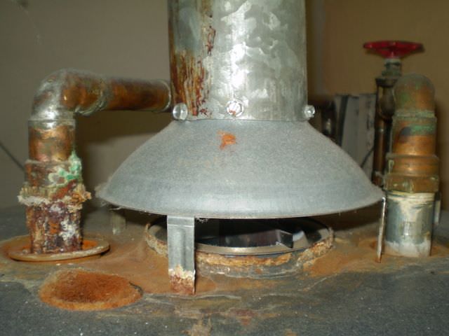

tnpappas Posted July 23, 2009 Report Share Posted July 23, 2009 The water heater vent is tied into the furnance vent. The vent to the exterior is practically horizontal. This is a five year old water heater. Is the damage here being caused by backdrafting or poor connection of the water entry pipes? Click to Enlarge 44.26 KB Click to Enlarge 45.21 KB Quote Link to comment Share on other sites More sharing options...
Inspectorjoe Posted July 23, 2009 Report Share Posted July 23, 2009 The water heater shouldn't tee into the furnace vent connector. You said "vent to the exterior". Was there a chimney, or did it just terminate outside? If it terminates outside, they should both be separate. If into a chimney, they should enter the chimney separately, with the water heater connector above the furnace connector. If the walls and ceilings are drywall, clearance is an issue. But I don't think the corrosion was caused by backdrafting. There has been so much moisture that it was puddling on the top of the water heater. The anode rod cap and the plastic bushing aren't melted on the side that faces the draft hood (the other bushing is missing). And the draft hood support legs are only rusted where the puddle of water was. I think the corrosion is from a leak at the nipple that sealed itself. Quote Link to comment Share on other sites More sharing options...
