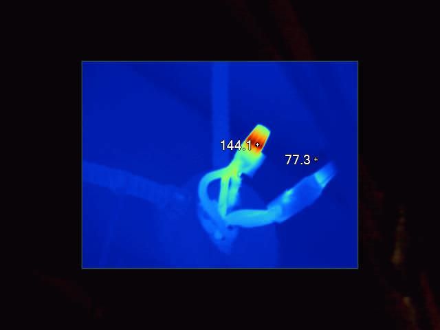

primitivelamps Posted March 4, 2011 Report Share Posted March 4, 2011 Yeah, the insulation thing isn't all that exciting, and there's always missing or inadequate insulation in Chicago. With the electrical, I haven't found much of anything. There's always a breaker or two that are a few degrees warmer than other breakers, but that's about it. The AFCI's are always several degrees warmer than other breakers. That's about it, but I'm not stopping trying to find stuff. You might be surprised how often there are poor connections at all those open boxes we (my self included before IR) walk by. I find a mositure leak of some sort that has no visible evidence at least one out every 15 homes. Major insulation issuses a couple times a week. Can't imagine not having the IR camera. Click to Enlarge 14.46 KB Quote Link to comment Share on other sites More sharing options...
