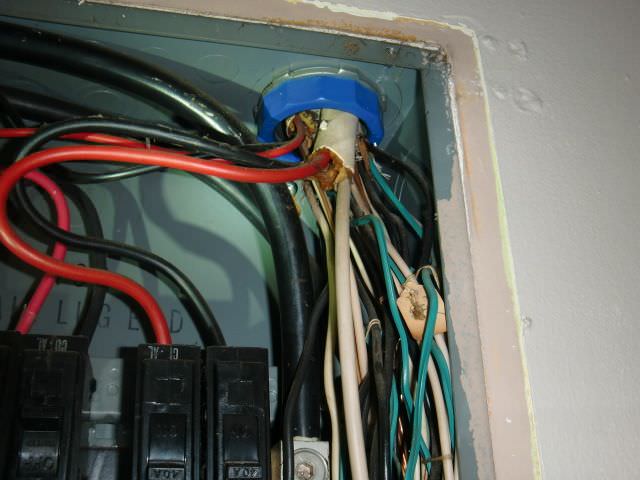

randynavarro Posted October 28, 2011 Report Share Posted October 28, 2011 How does this look? It seems pretty complicated to calculate over-fill for conduits and raceways. Any rules of thumb? Click to Enlarge 48.37 KB Quote Link to comment Share on other sites More sharing options...

Jim Port Posted October 30, 2011 Report Share Posted October 30, 2011 Although commonly done, that method of sleeving cables into the panel in that manner is only approved for surface mounted panels. Quote Link to comment Share on other sites More sharing options...
