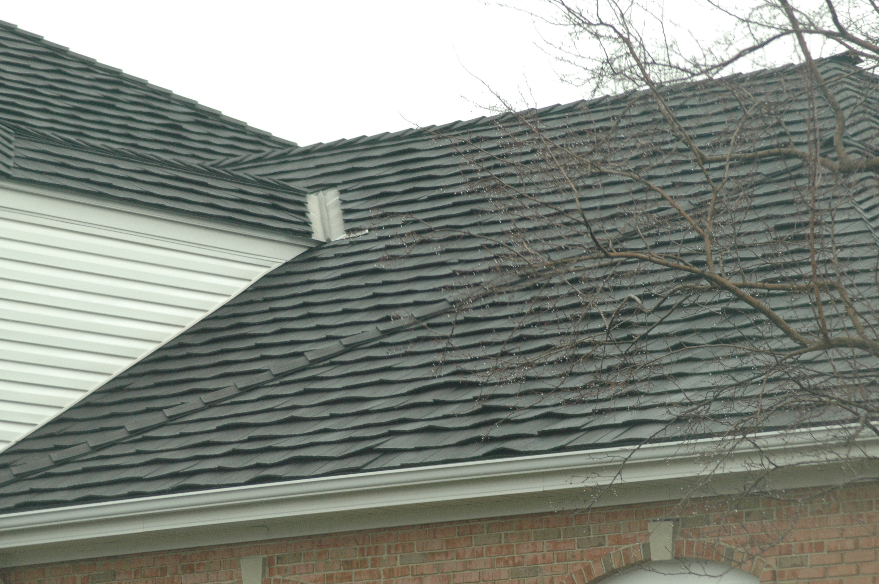

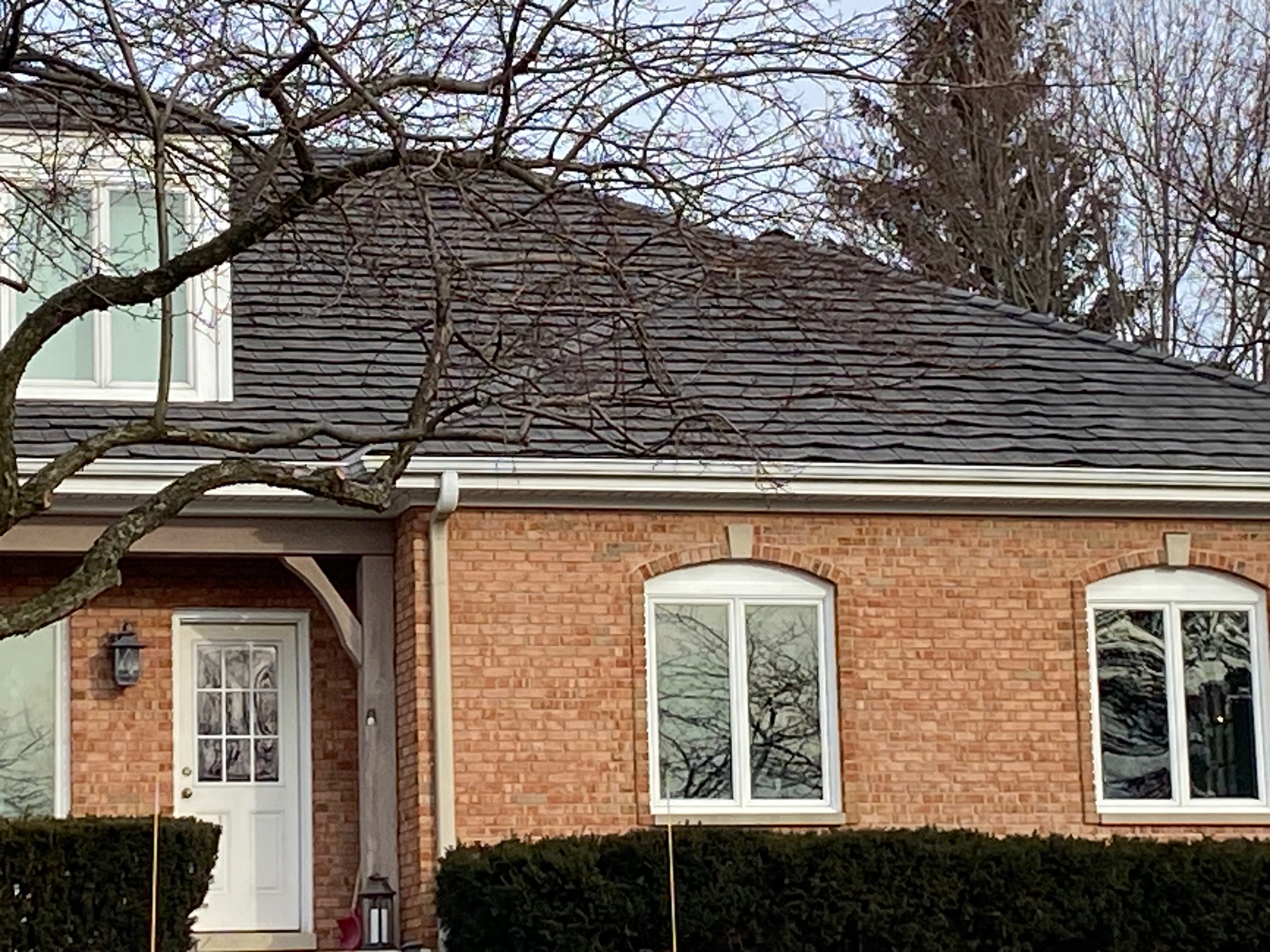

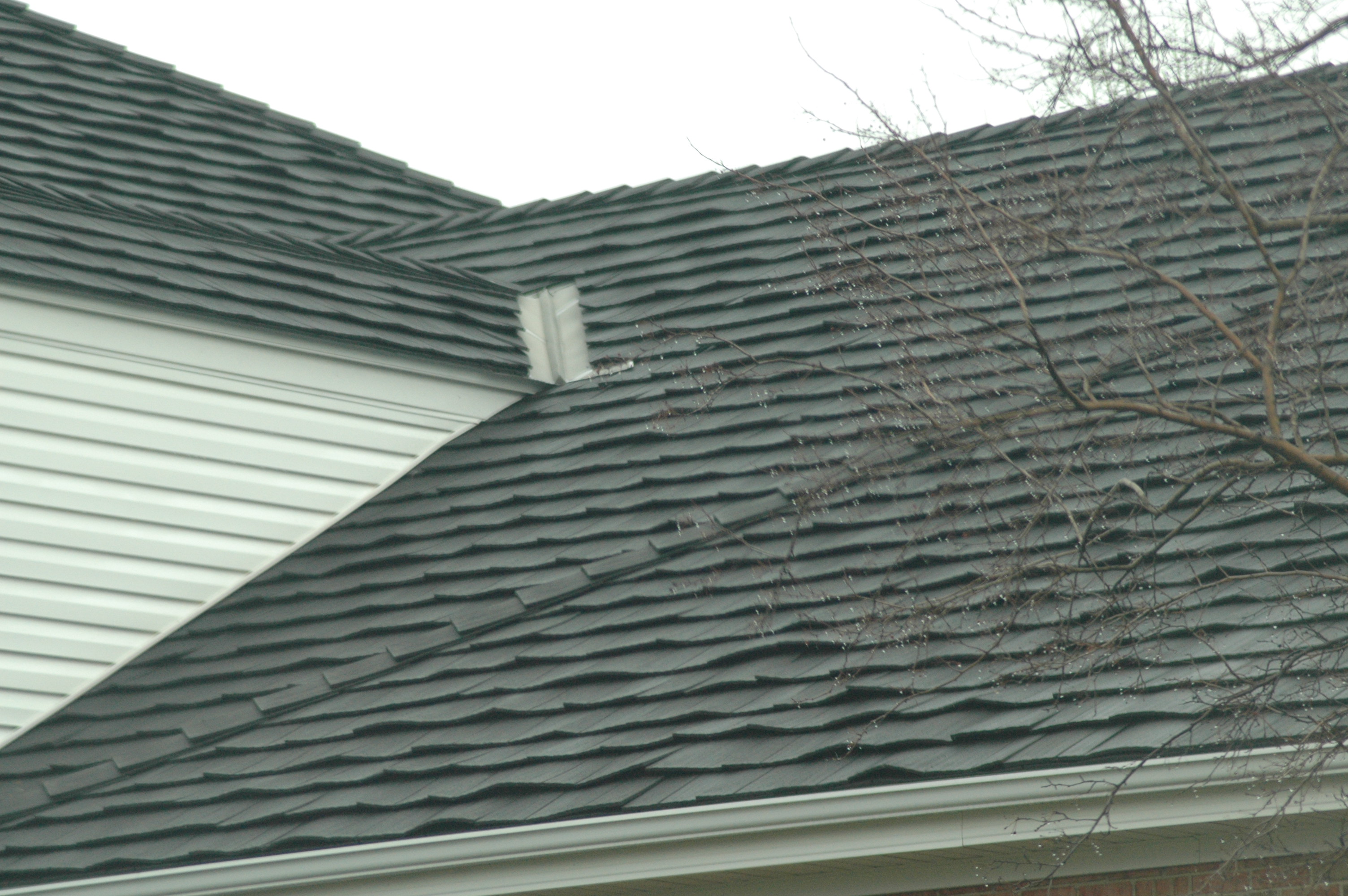

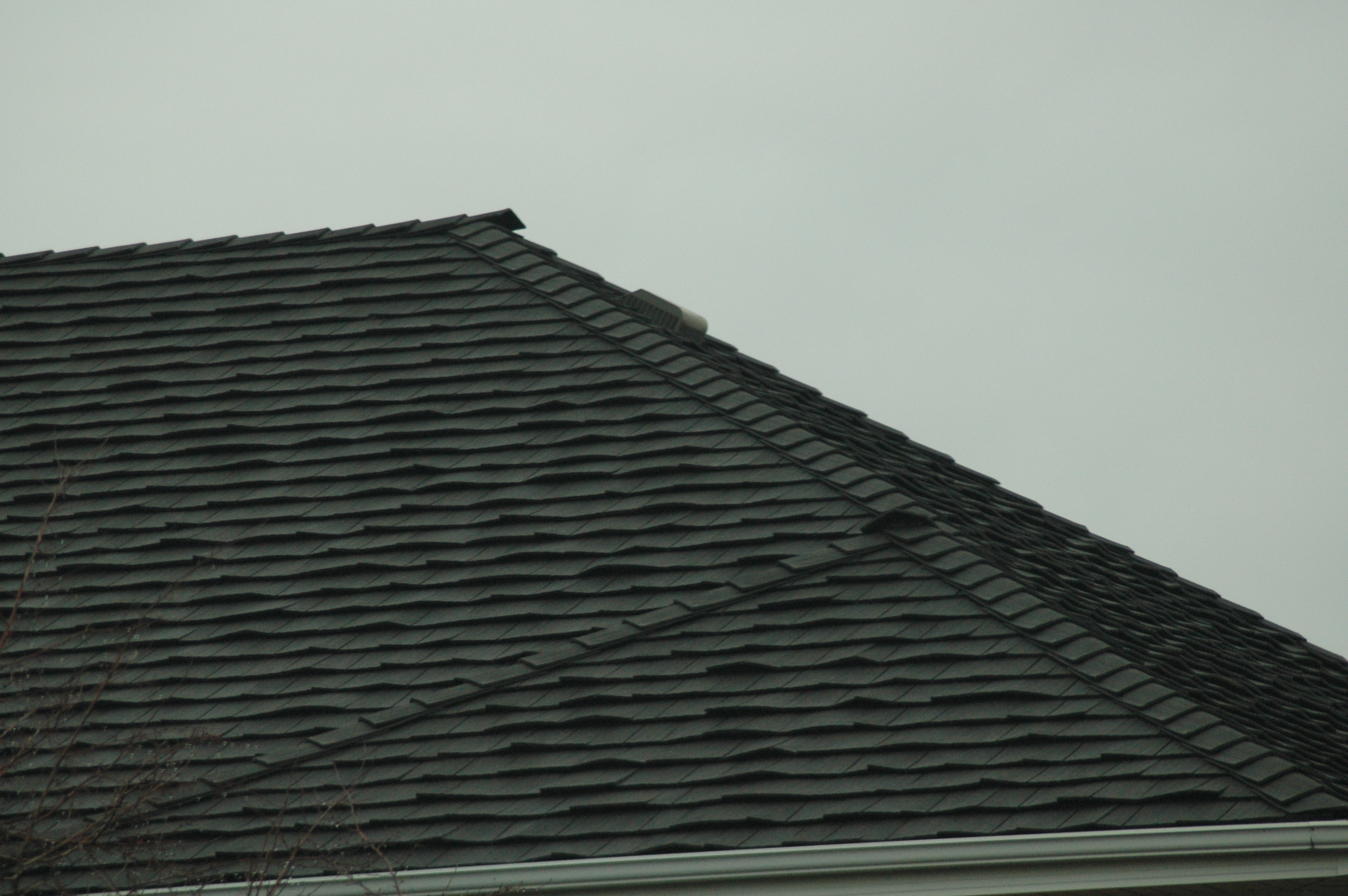

Poodle Posted February 27, 2023 Report Share Posted February 27, 2023 (edited) Need your professional input here: What's this roof? Material? Maybe even a manufacturer? Installed correctly? Why is it buckling? The home is located in NE Illinois. Thank you all for your input. Edited February 27, 2023 by Poodle added more high-resolution edits Quote Link to comment Share on other sites More sharing options...
Zach Cross Posted February 28, 2023 Report Share Posted February 28, 2023 It looks a lot like a composite shake, with maybe some heat warping but hard to tell without being up close. Don't see much of that around here in the Pacific NW, so I may be wrong. Quote Link to comment Share on other sites More sharing options...
Poodle Posted February 28, 2023 Author Report Share Posted February 28, 2023 Thanks, Zach. Someone said it is asphalt and someone said it might be a Brava....just trying to see if it could include or be partly asphalt. 🤔 Quote Link to comment Share on other sites More sharing options...
Tom Raymond Posted February 28, 2023 Report Share Posted February 28, 2023 It's a synthetic cedar shingle like Braava, Enviroshake, DaVinci, etc. It's either a defective shingle or it's installed incorrectly. In either event it's a complete tear off. 1 Quote Link to comment Share on other sites More sharing options...
