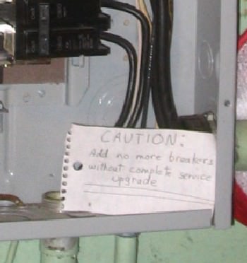

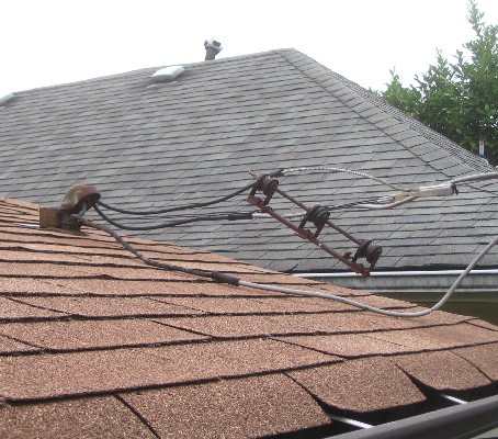

Richard Moore Posted July 26, 2006 Report Share Posted July 26, 2006 Great service drop!!! Tied to the original insulators which is then tied to the mast using a piece of rusty bailing wire (tough to see in the photo). FUBAR!!! Download Attachment: 0026.JPG 75.92 KB #2 cu SEC's to a newish panel with a 200-amp main breaker. Normally, I'd call that but then there was this handwritten note inside the panel. Download Attachment: 0046.JPG 29.8 KB That makes it all OK...doesn't it? [:-propell Quote Link to comment Share on other sites More sharing options...
Terence McCann Posted July 26, 2006 Report Share Posted July 26, 2006 I love the note. Signed Gomer, your handyman. Quote Link to comment Share on other sites More sharing options...
will5443 Posted August 7, 2006 Report Share Posted August 7, 2006 Unless I am looking at the picture wrong, that roof does look that old, maybe 8-14 years. Don't they get inspections in your part of the country. The mast does not come close to meeting code. Quote Link to comment Share on other sites More sharing options...

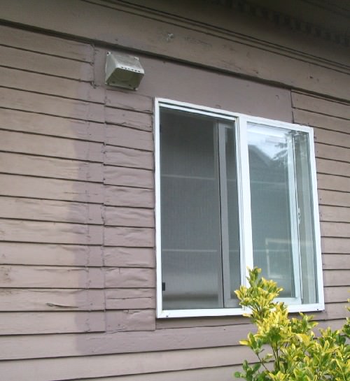

Richard Moore Posted August 7, 2006 Author Report Share Posted August 7, 2006 Bill, What happened here was a horribly added mudroom/laundry (basically looked like they filled in the rear porch). They then "blended" a shed roof into the original roof over that POS. Just an educated guess, but I imagine the service got upgraded a long time ago at which time they used the original 3-insulators as the attachment for the drop to a then new mast. All was well until the new roof. "Don't they get inspections in your part of the country?" Only when things are done with permits! The owner/landlord of this rental had screwed up every "improvement" he had made. Here's the only "upgraded" window, another example of his fine handywork... Download Attachment: blisteredwindow.JPG 66.78 KB Can you say "vapor barrier"? My client, the sitting tenant, decided not to pursue the purchase after the inspection. Scary thing is she is still living there while she looks elsewhere. Quote Link to comment Share on other sites More sharing options...
