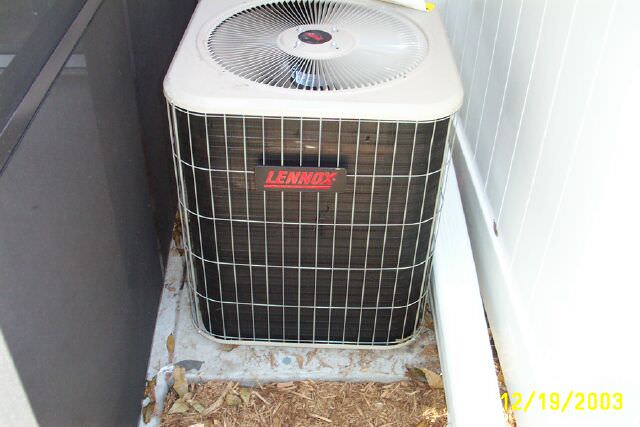

Danny Pritchard Posted February 25, 2004 Report Share Posted February 25, 2004 The pictures below are taken in a garage.The first picture shows the gas furnace and gas water heater.The second shows a register in the ceiling to supplement the supply air.The third is the attic view of the register. This is the second time I have seen this setup.The first was a few weeks ago during a framing inspection.I thought someone had gotten over zealous.This house is less than 2 years old and is in the same AHJ area as the first home I saw.Have any of the other Florida people seen this arrangement? Thanks Danny Pritchard Download Attachment: Register in garage0002.jpg 93.52 KB Download Attachment: Register in garage0003.jpg 58.74 KB Download Attachment: limited access ac0001.jpg 70.45 KB Link to comment Share on other sites More sharing options...
a46geo Posted February 25, 2004 Report Share Posted February 25, 2004 Danny, Check photo # 3. George Link to comment Share on other sites More sharing options...
