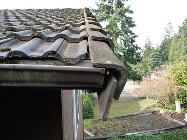

Robert Jones Posted December 4, 2009 Report Share Posted December 4, 2009 This is a home built in 1981, tile roof. On the north side of the roof the tiles which overlap the rake boards are seperated from the main roof. Could this be caused by a warping rake board? I am recommending repair for obvious reason's, plus a bunch of broken tiles, just curious. Click to Enlarge 67.36 KB Click to Enlarge 86.03 KB Click to Enlarge 60.67 KB Click to Enlarge 67.36 KB Click to Enlarge 53.78 KB Quote Link to comment Share on other sites More sharing options...
RobC Posted December 4, 2009 Report Share Posted December 4, 2009 Did you look at the roof from this angle? Download Attachment: RoofingConcFascia (Medium).jpg 48.56 KB If so, there is no need to call for repair. Quote Link to comment Share on other sites More sharing options...
Robert Jones Posted December 4, 2009 Author Report Share Posted December 4, 2009 Rob, I have added another pic showing that angle. There is rot damage to the eave and facia board in that area. I didn't see that type of flashing. Quote Link to comment Share on other sites More sharing options...
RobC Posted December 4, 2009 Report Share Posted December 4, 2009 Ok, that would worry me... Did you walk the roof and look at the underlayment, strapping and counter strapping? 81', you might not have counter strapping and that would have it's own negative implications. Quote Link to comment Share on other sites More sharing options...
Robert Jones Posted December 4, 2009 Author Report Share Posted December 4, 2009 I did not walk this roof. It was 33 degrees and more than enough ice on it to keep my butt off. Quote Link to comment Share on other sites More sharing options...
RobC Posted December 4, 2009 Report Share Posted December 4, 2009 Ok, did you push up the third row to look under the tile? The first two rows are generally nailed. Whenever you inspect a tile roof it's imperative to look underneath it to at least identify the underlayment and its condition. With the absence of counter strapping you could have quite a mess. Quote Link to comment Share on other sites More sharing options...
