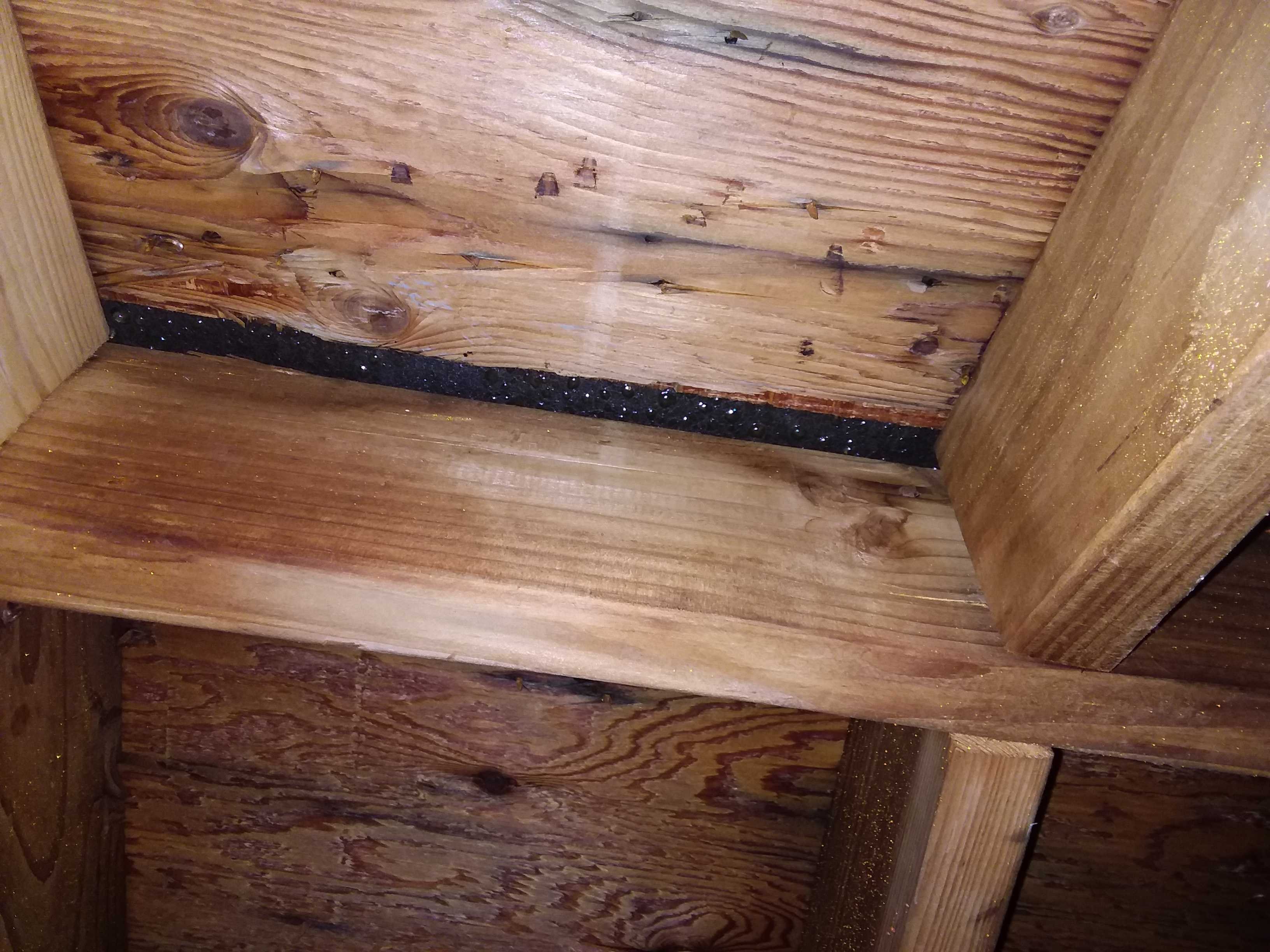

Detailed in previous posts above, I had black mold covering my attic that I needed to remove before I proceeded with my loan to buy my house. I have done everything I could do within my budget to keep heat and moisture out of my attic. I have recently sided and had all windows replaced in my all electric house with baseboard heaters. I had the siding guys cut in more holes for new soffits and installed baffles at every vent. I don't have a ridge vent but I have plenty of box vents and an attic exhaust fan. After pulling out the old insulation in my attic, sealing all holes and blowing in new insulation, I installed a range fan and bathroom fan (vented through the roof). The roof is about 8-10 years old with one layer of asphalt shingles. It recently snowed and I went up in the attic to check on things and noticed all of my sheathing is damp and at the peak of the roof there is active condensation drips. Is there anything else I can do to fix this issue or at least lessen it? Should I be thinking about a dehumidifier in the attic? TIA

Yes. You understand correctly. They are foam blocks with a foil backing. I can’t remember what the backing says. The mold was concentrated on the north and east side. The apex is where the garage is. That was another reason why I thought it could be due to the open attic.
The house is all electric. Gas line is capped off. No vents in the bath and no forced air. There are vents in the ceiling in all bedrooms but the previous owners cut blocks of insulation and put them in the vents. The duct work was laying in the attic. I don’t know where there could be interior air escaping. Maybe the mold is why they closed it up? I trust your input on this.
The attic is completely open to the garage. There is not a ceiling in my garage. There needs to be a separation between the two for carbon monoxide and fire code. By the way, I am not arguing with anyone. I’m new, I’m here to learn. So, because of the poor insulation I have interior heat coming into my attic and garage. Am I wrong to think that the sudden rush of freezing air into my attic is not accelerating the process?
I was told that every time the garage door was opened during the cold season, a blast of cold air flew into the garage and then attic. With my dated blown in insulation clogging the soffits and a degrading R value, there was no circulation and heat from the interior was building up in the attic. The condensation from cold to hot had nowhere to go. When I had the insulation removed and replaced, the old stuff was very damp. This is what I was told at the time. I would be interested in hearing any other thoughts. I suppose it was a combination of all of this
