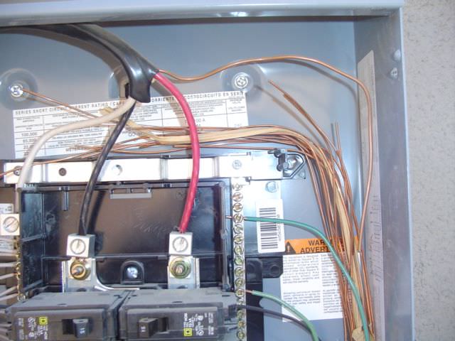

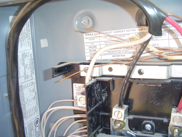

chrisprickett Posted March 10, 2005 Report Share Posted March 10, 2005 If you find the problem, congratulations, you're more observant than the sparky, superintendent, and muni inspector on this tract. Okay maybe this is a bit tongue-in-cheek. I think I will use these photos the next time I'm asked "it's a new house-why do I need a home inspection?" Pics are from a 2 1/2 year old, 800K house: Download Attachment: subpanel1.jpg 152.6 KB Download Attachment: subpanel2.jpg 155.85 KB Quote Link to comment Share on other sites More sharing options...
RobC Posted March 25, 2005 Report Share Posted March 25, 2005 Chris, You're kidding Right! Quote Link to comment Share on other sites More sharing options...
emalernee Posted March 25, 2005 Report Share Posted March 25, 2005 Air grounds! Ezra Malernee Canton, Ohio Quote Link to comment Share on other sites More sharing options...
Paul MacLean Posted March 25, 2005 Report Share Posted March 25, 2005 Reminds me of one I saw about a year ago. (Sorry no pics) Three year old house. In the subpanel the neutral cable was simply stuck in the neutral bus lug with no screw. The cable was loose as a goose. How they went three years without a problem I'll never know. Quote Link to comment Share on other sites More sharing options...
