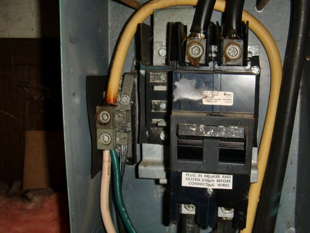

randynavarro Posted May 20, 2011 Report Share Posted May 20, 2011 At a mobile home inspection, I saw a 200-amp Zinsco brand main breaker switch at the exterior utility feed. Are Zinsco main breakers equally as problematic as the smaller breakers? Click to Enlarge 49.56 KB Link to comment Share on other sites More sharing options...
Jim Katen Posted May 20, 2011 Report Share Posted May 20, 2011 At a mobile home inspection, I saw a 200-amp Zinsco brand main breaker switch at the exterior utility feed. Are Zinsco main breakers equally as problematic as the smaller breakers? Click to Enlarge 49.56 KB I haven't found Zinsco breakers to be paritcularly problematic. The trouble I see over & over again is a problem with their connection to the busbar. Link to comment Share on other sites More sharing options...
