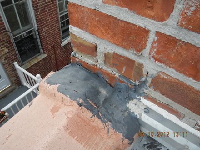

mthomas1 Posted August 12, 2012 Report Posted August 12, 2012 Assuming that there is no flashing under the tile to extend up the wall and counter flash, does anyone have a link to an effective flashing design for the junction of parapet wall coping tiles with adjacent vertical masonry such as these two chimneys? - Thanks Click to Enlarge 39.76?KB Click to Enlarge 26.02?KB

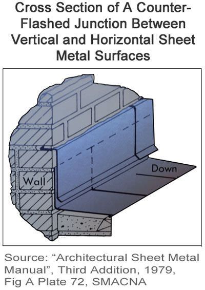

mthomas1 Posted August 14, 2012 Author Report Posted August 14, 2012 Thanks. There is also this, which I adapted from a scan from the ASMM: Click to Enlarge 44.32?KB However, none of these directly addres tile copings.

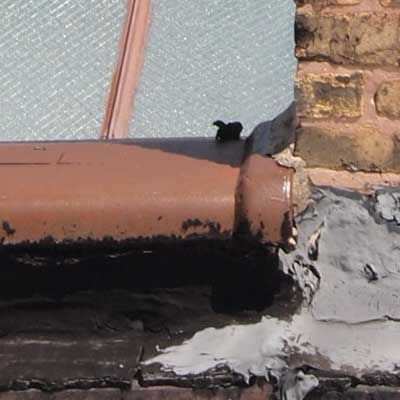

kurt Posted August 14, 2012 Report Posted August 14, 2012 In Chicago, a nice big slather of roofing cement is the standard approach. Click to Enlarge 68.1 KB
