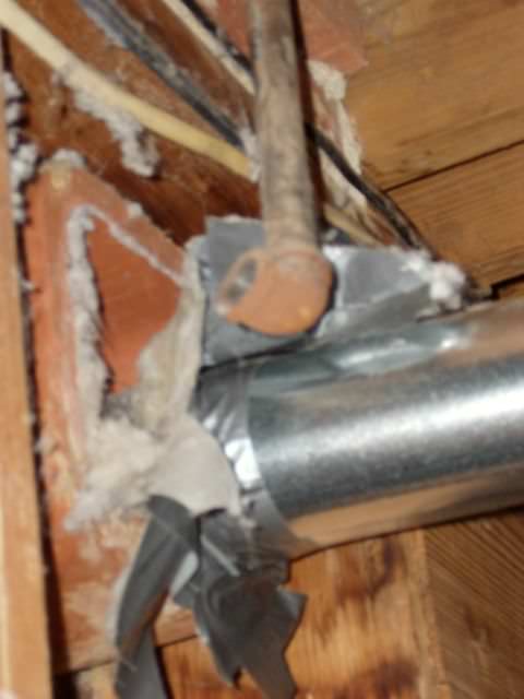

Unknown handyman came up with this assembly. Two incoming connectors are from clothes dryers, both joining the vent for a 105 gal. gas water heater whose exhaust terminates inside the chimney flue.

Over at the flue's thimble the assembly was shrouded in a big wad of duct tape, which, pulled away, revealed the lint pile.
