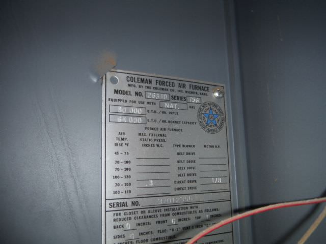

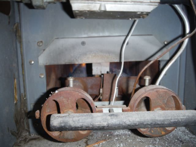

swarga Posted March 28, 2014 Report Share Posted March 28, 2014 Here is one, According to the date code this Coleman furnace was manufactured in 2001 but I didn't think they were still using pilot lights in 2001, this thing looks light it was built in 71, not 2001 Click to Enlarge 19.86 KB Click to Enlarge 33.15 KB Click to Enlarge 44.83 KB Quote Link to comment Share on other sites More sharing options...
Bill Kibbel Posted March 28, 2014 Report Share Posted March 28, 2014 Before '92 the Coleman serial numbers had 9 digits. Yours has only 8, so the first digit is probably missing. Quote Link to comment Share on other sites More sharing options...
