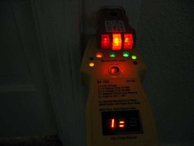

DonTx Posted July 19, 2006 Report Share Posted July 19, 2006 I've seen this before. The night lite has a dim light on the far right side. The SureTest indicates a non-grounded outlet. (If you only go by the three light tester, it's telling you everything is okay because the two yellow lights are lit) So why is the right light dim? Leakage? (it looks like the red light on the tester is lit, but I believe it's coming from the middle light, not the bulb itself) Edit: You know, the more I look at this photo, the more the red light does look like it's lit...hmmm Didn't seem that way in the home....go figure... Download Attachment: IMG_2955.jpg 19.4 KB Now this is an outlet on the other side of the room. Perfectly normal. Download Attachment: IMG_2956.jpg 20.6 KB Comments? Quote Link to comment Share on other sites More sharing options...
homnspector Posted July 19, 2006 Report Share Posted July 19, 2006 It looks to me like both testers are showing ungrounded. Quote Link to comment Share on other sites More sharing options...
