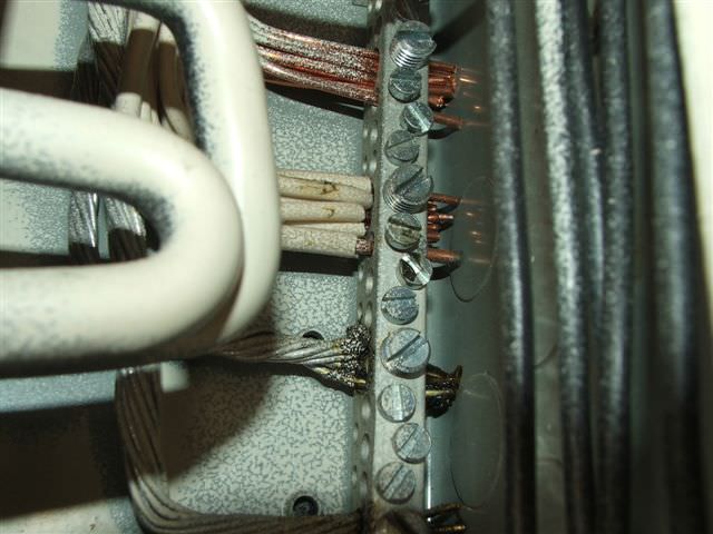

charlie Posted April 23, 2007 Report Share Posted April 23, 2007 What is the most neutrals anyone has seen under one screw. This is a record for me----at nine[:-bigeyes Download Attachment: nineneutrals.jpg 63.66 KB Quote Link to comment Share on other sites More sharing options...
rlskfoster Posted April 23, 2007 Report Share Posted April 23, 2007 You know the sad thing is that even with the larger hole, whoever did that had to work at it to get all nine in there. What a dope! How was the rest of th electrical. Quote Link to comment Share on other sites More sharing options...
tbird Posted April 23, 2007 Report Share Posted April 23, 2007 Borrowing a section from Jim Katen's double tap writings: Neutral Terminal Bars Neutral terminal bars are easier. They can have only one neutral wire (proper term ââ¬Ågrounded conductorâ⬠Quote Link to comment Share on other sites More sharing options...
