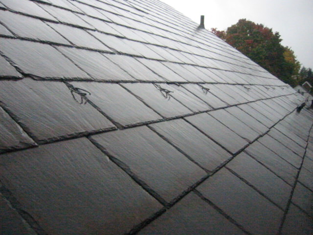

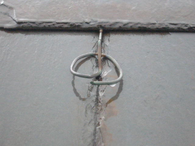

Inspectorjoe Posted October 26, 2008 Report Share Posted October 26, 2008 Today, I had a 58 year old house with a slate roof that had strange wire snow guards. I wasn't sure that they were snow guards until I googled "wire snow guards". Around these parts, cast 'Sieger' snow guards rule. I didn't come up with much, other than to confirm that they were in fact snow guards, and that this type is intended to be distributed uniformly across the entire roof, instead of just one or two rows near the bottom. In this installation, there was only one row, as would be done with a cast snow guard installation. Also, they all seem to be bent down, but the bend is pretty much uniform among all of them. As they're installed on this house, it's pretty clear that they aren't going to be very effective, so I'm going to recommend that 'traditional' guards be installed. I was just curious if these wire guards are used in other parts of the country. I see a lot of slate, and this is a first for me. Image Insert: 121.51 KB Image Insert: 84.4 KB Quote Link to comment Share on other sites More sharing options...
Bill Kibbel Posted October 26, 2008 Report Share Posted October 26, 2008 They're called "wire-loop" style snow guards. They were the most common style in the late 19th - early 20th century. They're not as common as the other styles now, but they're not unusual. They're still manufactured. There's a formula based on pitch, but there should be a minimum of 50 per square. The guards in your pics are all bent. From my 1899 A Treatise On Architecture And Building Construction Volume 3: "Should this form of guard be bent down by the weight of snow and ice, it may be readily pressed back, without breaking, into its proper position. Guards are also manufactured of cast iron, but, being clumsy, they are not to be recommended". Quote Link to comment Share on other sites More sharing options...

drcr Posted October 26, 2008 Report Share Posted October 26, 2008 Installed properly, you pretty much have to cover the whole roof, they do a good job and will last a long time. Original wire loop snow guards on house built in early 1900's. Quote Link to comment Share on other sites More sharing options...
